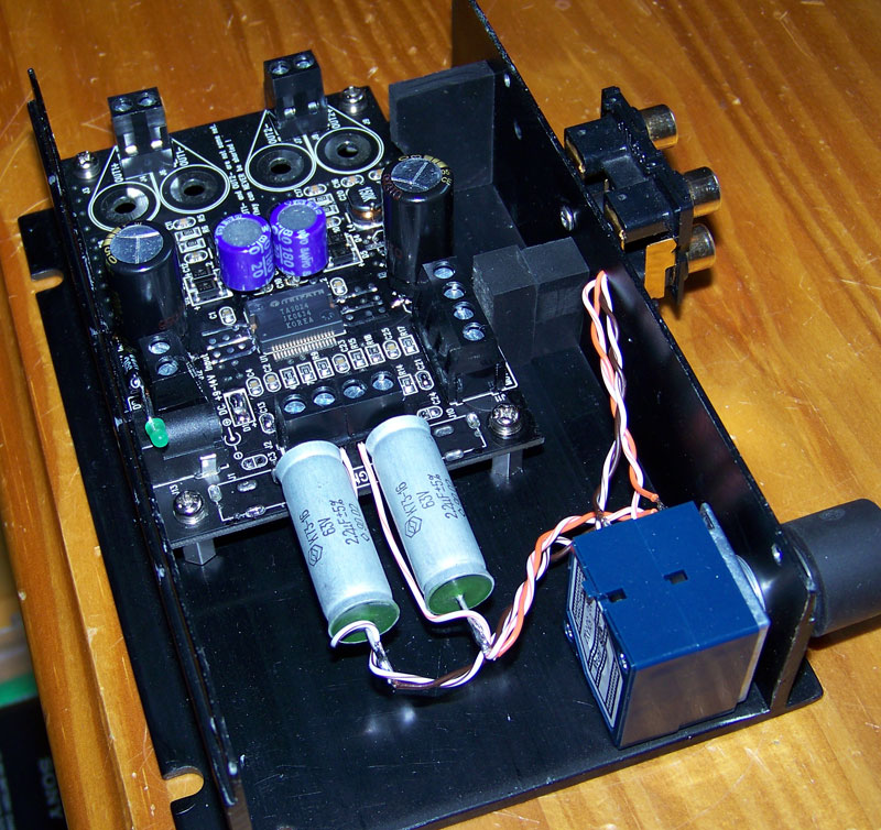

are the mods similar on the 2024c version? or any experience with this one, i cant see c3 or c24 on the board in the pic,,

Hi, hard to say without having one. You should use a DMM to check the layout, (like trace from input resistors to input caps) or kindly ask Sure for the circuit drawing.
As for TA2024C, my last PCB came with this and not with the former TA2024, no more R3/R16 wich where in most case a problem more than a fix.
But, I have a 43mV DC on one channel, I don't know if it's OK to live with or not? Anyone ever fried a speaker with such DC?
Also the ouptut caps are different, these SMD are half smaller.
I wanted to use amps at speakers to bi amp but seems I must use one amp for highs and one for low as they are not the same.

Hi i received my amplifier yesterday, i plan to squeeze it in an Lepai LP2020 Case. So i can have a 4 channel amp in a really small case ;-). The sure will drive the front speakers in my car, the lepai is used to drive a small sub.. and it does it well for ~1,5 years.
It will fit, but with heavy modifications. And what i noticed, i got a new revision of this board. Looks a little bit different, with dc-offset potentiometers too! It came adjusted (15-20mV), but now i am almost at 0,0 mV per channel. I am not sure if i need to change the input caps.
Uploaded with ImageShack.usHi i received my amplifier yesterday, i plan to squeeze it in an Lepai LP2020 Case. So i can have a 4 channel amp in a really small case ;-). The sure will drive the front speakers in my car, the lepai is used to drive a small sub.. and it does it well for ~1,5 years.

Bypass the input caps if you've got it at zero.
Aaaaand kaboom.... dead chip...
The thing is... I can not locate the input caps...
The input caps are a shy ceramic pair on this amp, almost feel ashamed to call them capacitors. They are the first components the input signal will see...
You can choose a better alternative, like a nice polyester capacitor rated at 63Vdc and 1uF. Don't go ridiculous on oil drum sized kilovolts rated nonsense caps is my advise....
