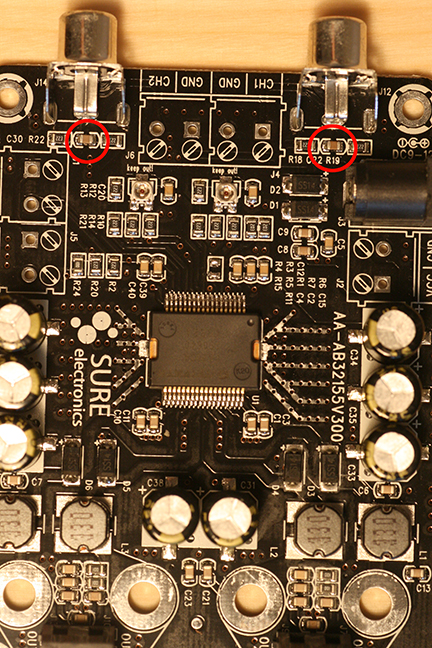

so that would be these:
and while I am at it... where to find the low pass filter situated here on the old board:
Tnx

It isn't to hard to improve the input section on this amp with better input capacitors, but as for the output section, which is clearly the weakest link in the chain there isn't much possible to improve it. Problem is the high switching frequency. Here the board, which is THE main component of the amplifier is impossible to improve without a re-design.
Though, without being all negative you may find some improvement from using better input capacitors. You do seem to have spotted them there indeed...
To elaborate on the above, as soon as one understands there are parasitic components of L, R and C in any board design and even in components these are not an issue as long as they do not present too much negative influence on the main functioning of the intended circuit. Here the output filter capacitors chosen are also ceramic. These are nice and small and do function, but are not even half as good as a polyester capacitor.
The problem arises when we would stick a bunch of polyester caps on the surface of the board and extend the leads, as I've seen many mods done. The extended wire length presents a series-connected parasitic inductor (L) and resistor (R) to the capacitor (C). The inductor will then start to radiate AND pickup magnetic energy, which is abundantly present in such an output filter. Usually the board designer has taken care of that in his design by a proper lay-out where the influences are for instance shielded by ground planes, or if that presents unwanted capacitive coupling he can place the component in a way that the energy is not influencing (see bifilar winding techniques for instance, or the placement of loudspeaker filter inductors)
THE problem here is the high frequency. As you may have noticed the higher frequencies we want to filter the lower the values we need. That can be an advantage, but with parasitic components it is a disadvantage. In these switching amps we are speaking of fairly high switching frequencies of up to 2,5Mhz in some models.
Reading the Tripath application notes there are some tips and tricks mentioned regarding optimal board lay-outs and these are not even always working out optimally. Bare in mind that the lay-outs ideally separate the effects of the output section as best possible from the input section, in order to prevent high frequency feedback and the resulting distortion and noise.
Now to improve the performance of such an amplifier topology takes a whole different way of reasoning than good oldfashioned amplifiers, though 99% of modifications the online crowd are on about directly project the knowledge of analogue audio circuitry on these switching amplifiers. Using air core inductors is one of them, and the use of polypropene capacitors in the in and output section. The fact that they are superior in speaker filters doesn't automatically mean they are the better choice in the signal path of these amps.
I have worked a great deal with TA2021B amplifiers using ceramic capacitors all over and I must say they sound pretty good due to the fantastic Tripath chip, but after experiencing a design which accomodates film capacitors in the output filter and as input capacitors it is clear which one is the winner.
P.S. I don't want to try to discourage modding this little amplifier, it's a great learning experience. Just don't expect nirvana in the end. All I want to give is some guidelines in the considerations of choosing parts and design lay-out of such an amplifier. And I want to warn those who plan on sticking on expensive "boutique" parts it is a waste of money and effort and just hope to prevent disappointments.

Well I hope someone is still subscribing to this thread. I have the newest version of this amp and am wondering whether it is still recommended to remove C3, C24, R3 and R16. The configuration around C3 and C24 is quite different with a resistor on either side of the caps. I this something Sure has done to correct the problem with these caps.
You might read my post http://www.diyaudio.com/forums/class-d/203835-sureta-2024-board-integrated-lepai-lp-2020-quad-channel-amp.html , there you could see how i have modified my board. Should be the same revision...

Thanks for the link- I had looked at it before but didn't realize it was the new version of the board. Could you kindly tell me which caps you used and exactly where you soldered them in. Also did you remove and caps or resisters as per the old board mods.

I have to quote myself here 🙂
Then i changed C22 and C30 against 2,2uF MKP from WIMA.
There you could also see, where i added caps for the supply.
I removed the ceramic caps, and soldered these 2,2uF caps on the solderpads. But be really careful, bend them as good as possible. Then i fixed everything with hot glue. If you bend these a little, the solderpad might come off quite easily! You also might add some of the caps for stabilising the power supply a little. Might help a little with deep bass. I drive 2 16cm speakers in my car, and the bass /highs are better than with the integrated amp from my poineer radio. Not much louder, but sounds fine with CD's. But the tripath amps are surely jam my radio - a lot!
Well- it might take a while. I destroyed the one I had taking off the wrong resistors. There are a couple new ones coming from Sure.
Does anybody know which ones the input caps are in this new Sure amp? I would like to replace them whith some really good ones, and I don't think that SMD caps are the best ones.
