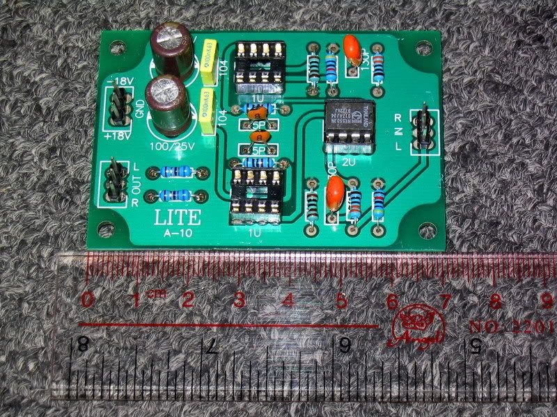

Thanks Franz, one thing is still not clear to me: in order to reach unity gain or something very close to it should I change some of the board resistors or just short a couple of the opamp's pins?
Unfortunately I still don't have the board in my hands...
Pincellone
Did you receive the board? Do you know, what to modify? I have one of them and could give you the needed hints, if desired.

Thanks Franz. It is still not clear to me if you actually tried the buffer I can see in the picture with the Sure board and whether or not you found an improvement by using it compared to a volume pot directly connected to the Sure (I'm using an Alps Blu RK27 25K as I was not satisfied with the performances of the 50k and 100k).
I hope to receive the preamp board soon, the only mod would be bringing it to unity gain and use it as a preamp for the sure board (if this is really worth it...) In that case it would be interesting to know what to modify to get lower the gain as much as possible.

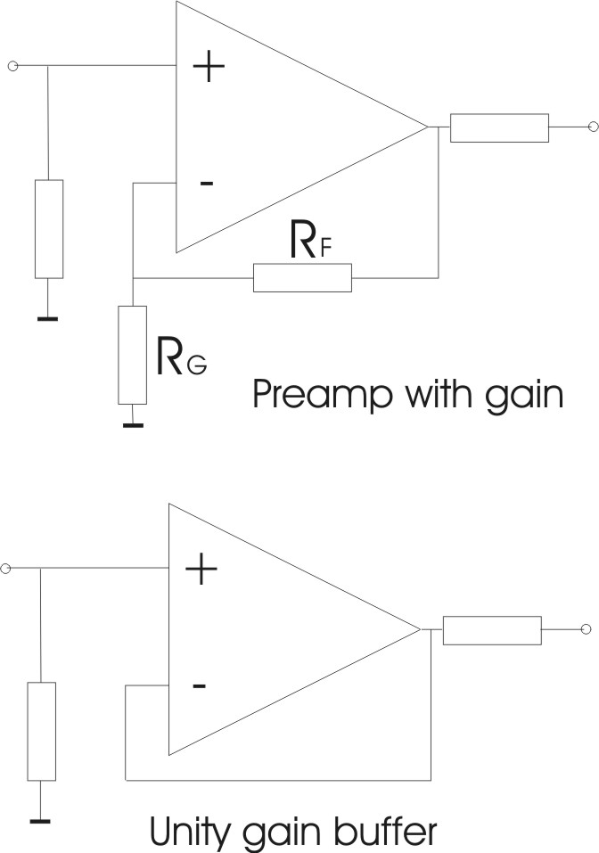

Zigis, thanks for the info.
I don't have the schematics of the preamp, but it seems to me that I should connect some pins of the dual opamp and remove a couple of resistors. Is that correct?
If so, could you please let me know which ones are they?
Here is the pinout of a dual opamp and the picture of the preamplifier. Thanks!

Yes, you need to remove 4 resistors for stereo, hard to say by photo which one, PCB is 2 sides.
Wen you get amp, find 2 resistors who go from pin 1 to pin 2 and from pin 7 to pin 6 and remove.
Than find 2 resistors from pin 2 to ground and from pin 6 to ground and remove both.
Then connect pin 1 to 2 and 6 to 7.
Zigis.
