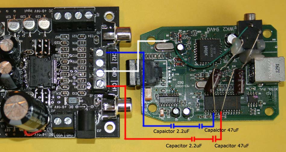

I want to connect a external usb sound card directly to my amp.
I bought the sound card at ebay:
http://cgi.ebay.com/PCLINK-USB-DAC-...ryZ96887QQssPageNameZWDVWQQrdZ1QQcmdZViewItem
I have two questions.
1.
If you look at the UDA 1321 data sheet (page 37) it is written that you should connect a 47uF capacitor after the audio output. But since I'm going to connect it to the sure electronics t-amp with the 2,2UF capacitors, will the 47uF really be necessary?
http://pdf1.alldatasheet.co.kr/datasheet-pdf/view/19847/PHILIPS/UDA1321PS/N101.html
2.
Since the power that comes from the USB is full of noise Im thinking of taking the power from the same source as the amp using a voltage regulator. Would this be a good idea? Will the computer be able to detect the sound card?
If I choose to use the power from the USB the ground will be different? Can i still connect the white cable (in my picture) to signal GND in the amp? What should I look out for?

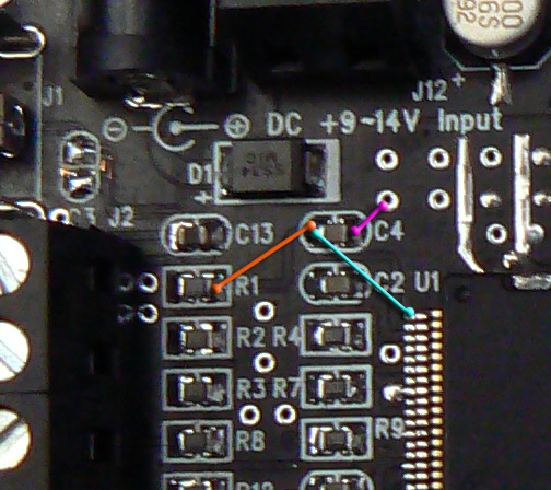

If the pad of C4 has been destroyed,do you know an alternative for connecting the capacitor?
It's not for me, but a friend of mine is asking around and I'd like to help him out...
Pincellone wrote: If the pad of C4 has been destroyed,do you know an alternative for connecting the capacitor?
C4 is the supply decoupling cap from V5D (pin 4) to Gnd. The right hand pad, (Chip side) is @ Gnd potential according to my DMM so I hope your mate, for his sake, has lifted that one. The closest unused hole in the board is also at Gnd potential so use that.
If he has lifted the other pad, he is going to need a steady hand & better eyesight than me to solder directly to Pin 4 .
C4 on my board measures 1.3 nF.
Paul
Paul
pincellone said:If the pad of C4 has been destroyed,do you know an alternative for connecting the capacitor?
If you are still having trouble here are the points to connect to;
ZL2BPS said:
The Signal originally fed through C21 left pad to C21 Right pad then to right pad on R14.
You can therefor put your new Cap between C21 Left Pad ( or the RCA Connector ) & R14 Right pad. OK?? You can check that with a DMM.
Audio 1st posted a full input & output circuit diagram of this board many posts back. Search his postings.
Paul
Thanks for the reply.I have to also change R14 resistor itself,it´s broken.
I have an another decent sounding Sure amp,which has C3,C24 caps removed and an Elna Silmic 2 1000uf/25v caps in the power rails,so not big hurry to get that another one working.
Thanks Audio1st!
