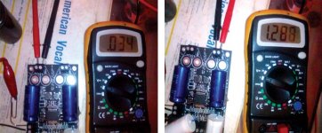

I cannot read the scale on your meter but believe you are indicating you have 34mV DC Offset on the left channel which is about correct & 1.288 V on the right channel which is way too much . Is that correct & what was the DC offset when you started ??
What mod's have you done & what are the large white item's in the bottom of your photo, are they your new input capacitors ?? They look to be too large to be soldered reliably to the board Pad's & should be mounted elswhere ie between the sweeper of your pot & the input to the board.
Is only the right channel not working ?? Is the left channel OK ??
Go over your work & look for solder bridges, anything shorting out, broken or lifted track's & check all your components against the circuit diagram.
It's a bit hard to diagnose your problem from 6,000 miles away.
Paul

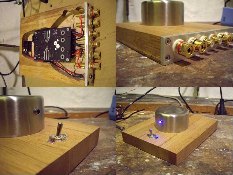

I have applied these mods:
C21 & C13 replaced with 2.2uf caps
C3 & C24 removed.
R3 & R16 replaced with 1M ohms.
R1 replaced with 27k resistor and R18 replaced with 33k resistor (this lowered the dc offset to under 20mV on both channels I used a trim pot to found the right values)
Two 4700uf 25V caps added on rails.
What will removing and bridge D1 do?
I think removing C3 and C24 was the biggest improvement. It really opened up in the hights. I was so pleased with it so I decided to build a case for it.
And no. My intention was not to design the case to look like the war ship monitor, it just came out that way 🙂

Seriously, removing D1 will only slightly increase the voltage. It's not worth it, that diode protects the chip against polarity inversion, You'd better leave it in place...
OK, OK, I know you meant that it looks like a tank, but I realized that only on a second thought😀
very stylish - I like it!
I didn't get how you could fit all that wood around the board, the top left picture doesn't really show it. Did you mill the inside of the board or is it mitered slats you have for the side and back panels? Could you post more pictures please?
Also I'm curious whether there is anything under the turret.
Cheers
PS: I read the monitor was a swedish design too - must be genetic
Cheers

Here is some more pictures.
And once again the "monitor" look was'nt any design idea. When finished it just looked that way 🙂 Maybe it is genetic. I hope my next project does'nt come out as a monitor as well 🙂
Building pics
Building pics
Hah, I like it. A nice, clean design. I'm thinking of putting my board into an old Sega Megadrive/Genesis console case 🙂
Paul
Hi Paul!!
Thank you so much for your reply. Your understanding is correct!! You said everything right for what i have done. I had made it following from your photo. The white one is mundof 3.3uf. Right now i had correct it till the small plate broken. This is the second board that i had destroyed it 🙁 I think board of Arjen will easily mod than this surelectronic board
