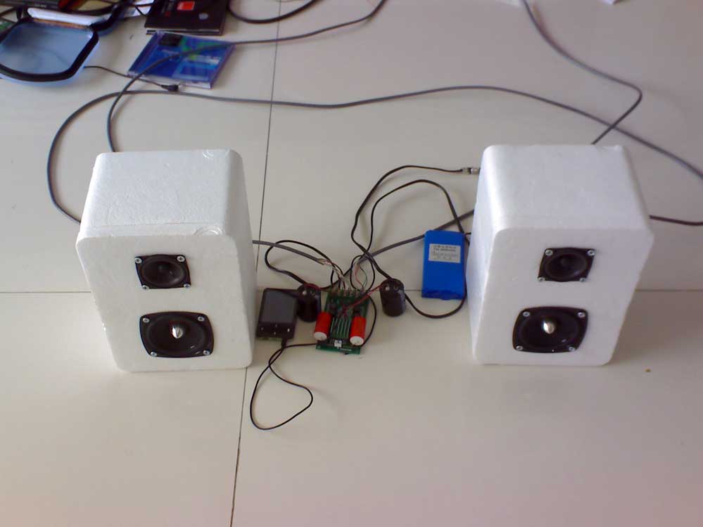

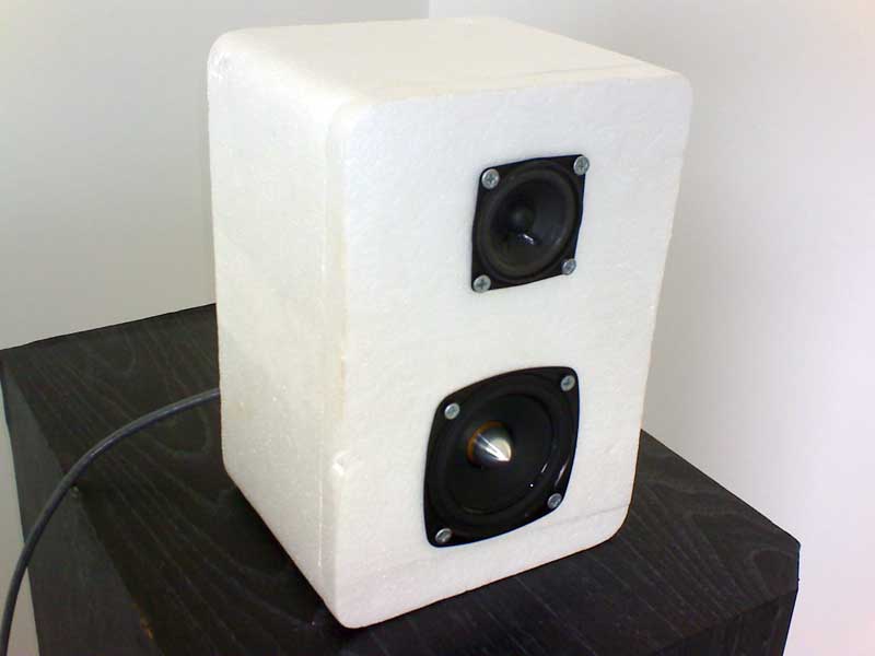

Hi all. after 2 hours of oldfashioned tinkering i have made a pair of loudspeakers matching the Cheap T-amp like a glove.
Exellent mids ang highs, very fast and very clear accaptable lows, not to deep, because of the 3" drivers, but for a small set, verry nice.
This has been made for 10 euro's..... all new components.
The housing is made of Styrofoam cooling boxes used for food.
These are 0.5 euro each
The drivers are one pair of 3" almoast fullrange speakers that need a little help above 12K that help comes from full range speakers of 1" diameter, housed in a metal can. i used a 6uF 250 V MKP cap to cut the low out for the small one.
the housing is a bassreflex with a bass hole in the back, the styrofoam is relativly hard ( for styrofoam that is...) so i braced it on the inside with cardboard .
All cost me 10 euro and 2 hours time, sound is amazing for this price!!! very suitable for Jazz and any vocal music, and with the T- amp beeing so cheap, a excellent start for anyone who is interested in HIFI.

Very nice!
Looks like a candidate for a beach machine, lightweight but serious.

Styrofoam speakers
Thanks there jiggen,
These boxes i think you can also get where you leave, and if you want the drivers, i sell them at a very mild price.
ofcource you can also try what you can find locally, in holland i alwais tried second hand shops, sometimes you can get really lucky and get some old ugly philips speakers from the 70's, but those are amazing!!! Luckely no one knows about this hehe
Good luck!
