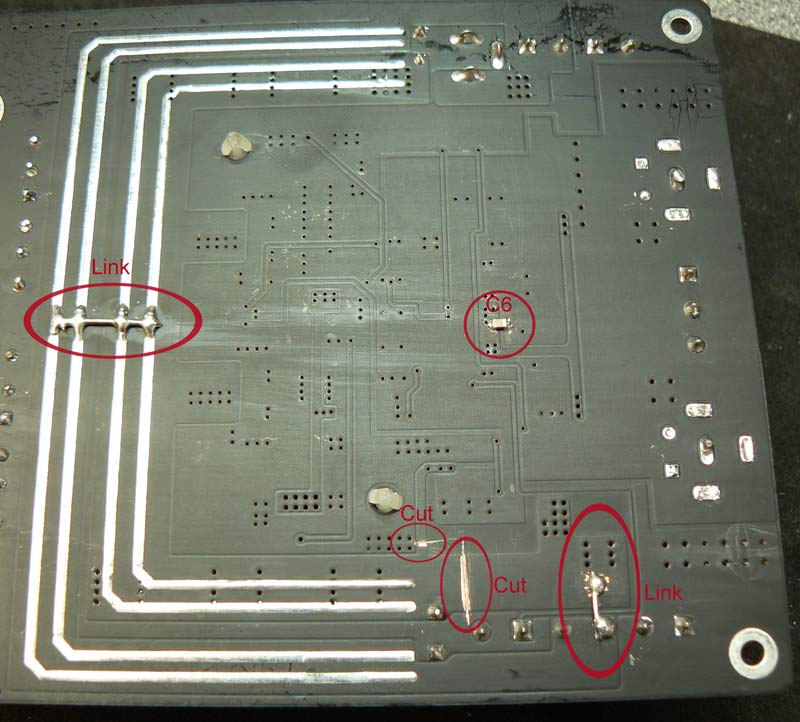

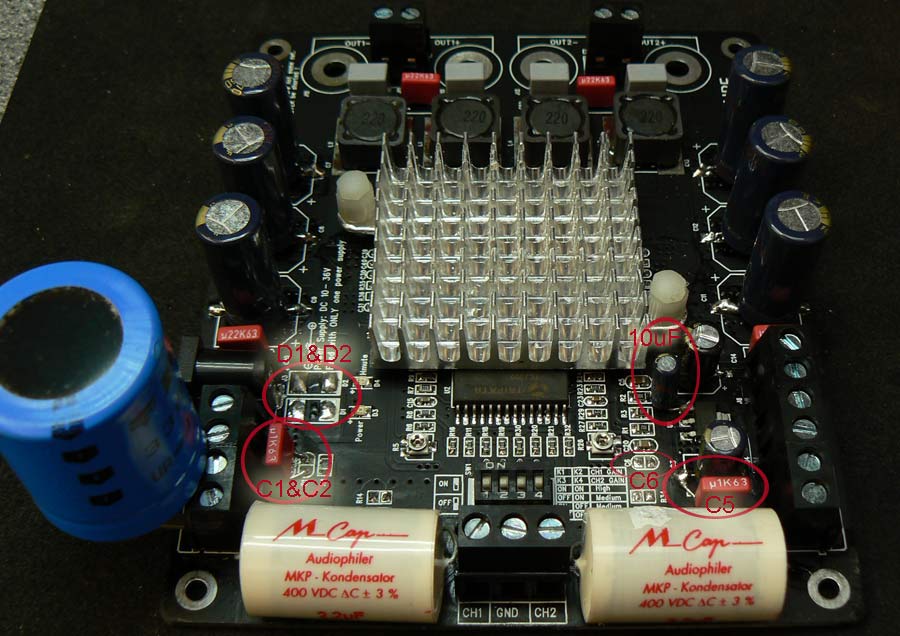

I think I have taken the board as far as I can?
Changed all the lytic's for Pany FC's, changed all the film caps, better quality, same values.
Removed C1 and C2 and replaced with a single 100nF Wima film cap.
Moved C6 to underside of board. Replaced C5 with a 100nF Wima film cap.

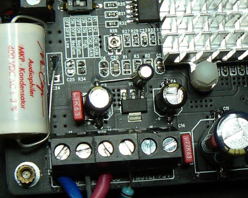

Added a 10uF Pany to the adjust leg of the 5V reg.
Removed D1 and D2 and re-routed the power supply.
PS this is just what I have done and is not necessarily a recommendation.😉

1. In the 5V regulator, you put the 10uf cap in parallel with R2, correct?
2. It looks like you'd need to jumper D1 and D2 if removed - I take it your trace cutting and jumpering accomplish that and more?
3. Why move C6 to below the PCB - to get it closer to the chip?
4. You have a large blue PS reservoir cap on the side of your PCB - what value do you suggest?
Thanks again.
Best regards,
Mike

Hi Mike,
1. Yes, I connected it between the adjust (1) leg and ground side of C4, I may change that to the ground side of C3. Neg to ground.
2. Yes the links bypass these diodes. You could use diodes in place of the links to be safer.
3. Yes, Tripath always state that this cap should be as close to their chips as possible. Short path to ground.
4. I used a 3,300uF, I tried larger but the switch mode PS did not like it. Other PS will behave differently and something up to 20,000uF could work.

@audio1st
can you tell me why you modded it and what the mods are supposted to do?
becouse i can just mod it like you did but i want to know what the mods are supposted to do.
like, why did you remove the diodes, and does replacing C1 and C2 with 1 cap affect the input filter and how much?
and why did you reroutet the power supply, is the circuit boards routing bad?
