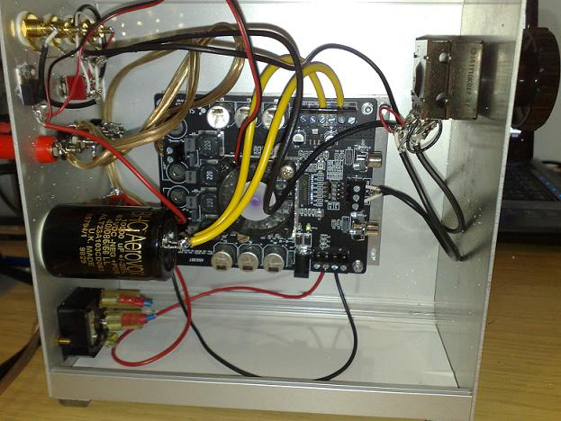

Re: heat problem
Thats looking good there,
what type of power supply are using?
How did you construct your case?
youp said:I found a nice case and I solved the "heatproblem" with an aluminium block and a 12V fan. The heatsink doesn't get warm at all now.
On the picture you can see the progress so far.........
I am currently using a philips 450W 32V smps. but the fan makes too much noise. I was lucky and had the case lying around. I made it very simple with a switch to select between 2 audio-channels and a potentiometer for the volume. I used a 7812 to make 12V out of the 32V for the fan.
