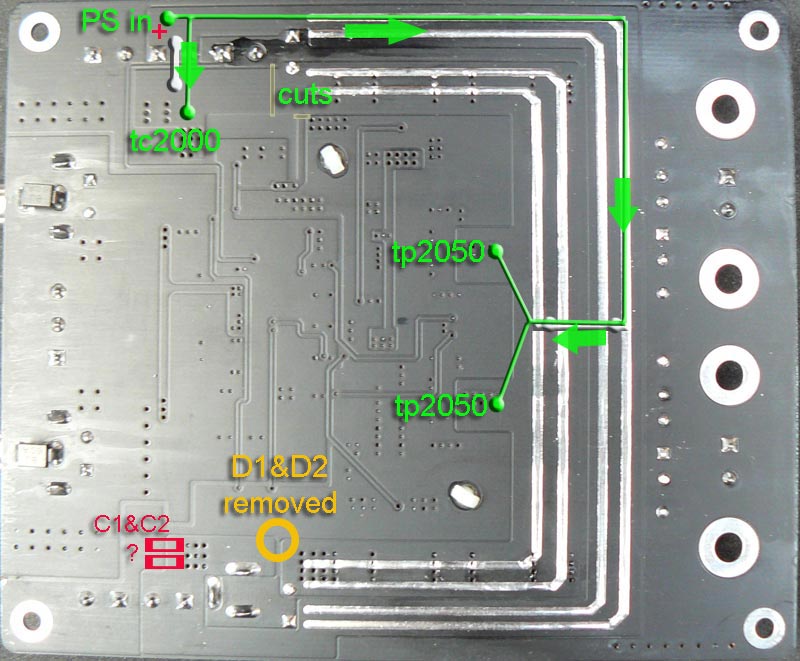

The mods you refer to are just the final touches, if you are still trying different power supplies, then I don't recommend you remove the diodes or re route the power..
C1 and C2, also C5 are in parallel with the new power supply caps which are now low ESR, so they are replaced with better quality.
I didn't think the PS routing was perfect as it was.
Note, C1 and C2 are not input filter caps, the input filter caps are C16,C17 and C24,C25. This is the most important mod. Remove the 4 caps and replace C16 and C24 with something like THIS

Audio1st,
can you pls elaborate on the rerouting of the power rails?
I can follow the idea of shorting the diodes and doubling the rail. But what is the notion behind the cuts and bridge around the LM317?
Also you seem to have taken out almost any ol' cap on the board.
Putting some low ESR around the rail like C7-9 and C11-13 seems like a good idea to me, too. Do you find it necessary to actually eliminate the original caps on these spaces? I figure even if there are lower ESRs around the original caps shouldn't hurt or can they?
Also C1&2 seem non-suspect to me, what was your reason for getting at them?
Lastly, you replaced some caps in the output stage, but not all of them. Is there something we can learn from this?
thx

Hi ElFishi,
As I said the mods are just what I have done for my own use and are not necessarily a recommendation..
I am very happy with my boards and have just shared some ideas.

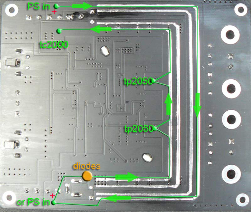

Here is a picture of the original PS route.

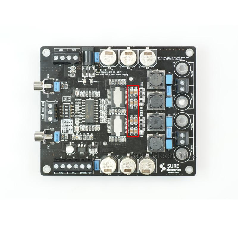

You have zobel caps on your board (C34, C48) and resistors? My sure board didn't have zobel components on board, thats why it was a bit rough on highs. After adding zobel filter the sound was much nicer, also change these grey caps(output capacitors) with something better.
Regards Ales
I think that all these boards from sure are without zobel network.

I still can't follow your cut of the little streak leading up to C5 (I guess). Isn't that unconnected now?

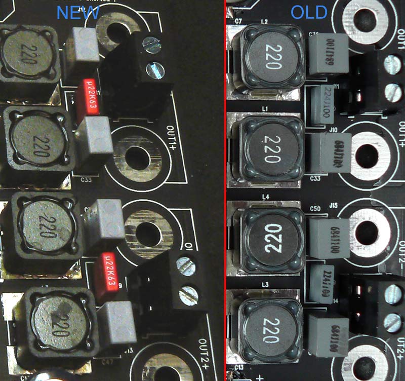

Also, am I wrong or did you replace the output inductors, too? They look different and yet so similar.
After reading Ales' remark I checked with my board to find that indeed C34,48 and R38-41,45-48 are missing.
If you look at the picture from sure-electronics as attached to the first post of this thread you could get the feeling that these components are missing there, too.

SURE do some strange things, who knows why they decided to leave them off?
I hadn't removed my heatsink, it is very well attached to the chip and didn't fancy the chip coming off with the heatsink.
I may now try a Zobel across the speaker terminals and thanks to Ales for spotting the missing parts.
The cut to C5 was easier for me than removing C5. I added a 100nF Wima across C3 to replace it, just my preference..
I have 2 boards so that is why the inductors look different.
Another thing that bothers me is that bypass caps have value 6.8uF(caps in read rectangle) instead of 100nF also I think that big mistake is that the config pin(24 on TP2050) is connected to the ground instead of connecting it to the vdd pins(21,22 on TP2050). Now these two pins are connected on the 5V line via 10k resistor. I increased value to the 47k but nothing significant happened, I was hopping that I will reduce heat but without any luck.
