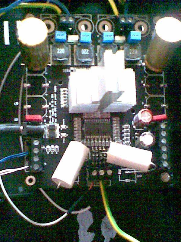

hi.
sorry for my bad, very bad english.
i have brought the change for this sure electronic like the "little sister" 2*15W.
the last thing i must to do will be take out the DC protection diode.
this sure based on the TK2050 don't convince me.
there is not the "magic" as the little.
no bass frequences, too much high frequences.
almost with my speakers OB based on the philips 9710M full range speakers + woofer grundig vintage(from the seventy).
i will prove the power stabilized supply 24v.
i wish a nice day everybody.
