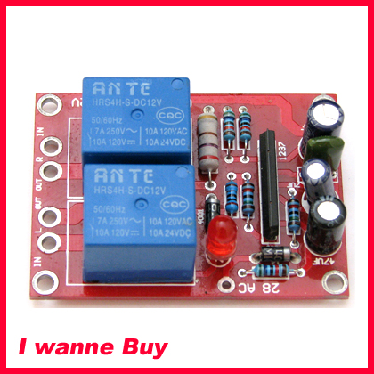

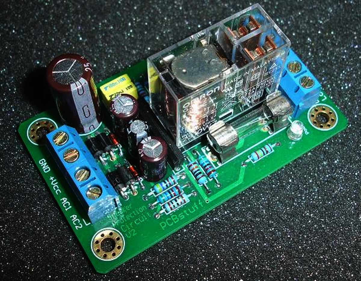

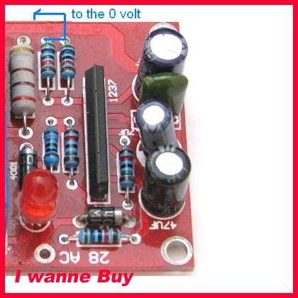

I have figured out how to implement a $20 speaker protection board from Connexelectronics in order to eliminate the turn on/ turn off thump and will post the details when I receive the modules and get them wired up to make sure it works as I anticipate it will. Sometimes shipping from China takes quite a while. Larger input caps on the 2X100 increase the thump.
Speaker protection module
I ordered these speaker protection modules from Cristi at connexelectronic.
Connexelectronic
He is a good contributor to DIY Audio and makes some of the best designs. He has two amp modules which may be among the worlds best at any price with his 3020 amp and the LME49810 amps. I also purchased small transformers
Digi-Key - 567-1035-5-ND (Manufacturer - BV030-7329.0)
from Digikey in order to provide the dedicated power supply that is needed in order to allow the dc protection to work with the Sure 2X100 which is bridged so a floating 0v offset point relative to the dc level which is present on all four speaker terminals must be created.
