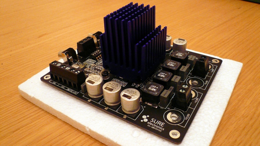

Hi all,
Just completed "stage 2" of the build and modded the board. Replacing the inductors went far better than expected - mostly because:
a) I used a relatively cheap, but temperature controlled iron
b) I removed the heatsink before replacing them, giving better soldering access.
c) I took on Sendler's advice about heating one side of the inductor (until the solder liquefies) and prizing it up with a small flat bladed screw driver
d) After prizing it up, completed the extraction by holding the top of the inductor with a pair of long nose pliers, heating the other side until it liquefies and it should easily pull off.
e) Tinned the new inductor solder pads
f) Tinned the board solder pads
g) Soldered while making sure the solder liquefies. May take a couple of goes
h) Measured the resistance between the pads
Interesting that the old 22uF inductors measured between 10-11 Ohms and the new Wurth 4.7uF measures 0.9-1.0 Ohms. Implying about 5x the impedance reduction of due to a reduction in coil length and a further 2x reduction due to increased coil diameter. All good 🙂
Then I added the nice looking Zalman heatsink (just using an extra tiny 'rice-grain' bit of compound). Getting the legs in the right position was probably the fiddliest bit, but not bad at all.
Then did the full set of input mods suggested by Audio1st.
See the attachments for some pretty pictures.
Stage 3 is to file off the drilled holes in the enclosure (which I did earlier).

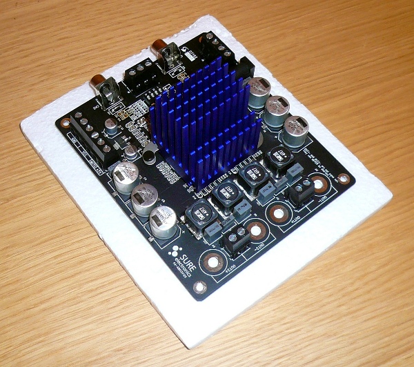

I just build another module today, including the following mods:
1) replaced inductors with 4.7uH wurth xxl (they get very very hot :S)
2) replaced all output caps with 0.47uF dayton polypro foils
3) added zobel network, 0.47 dayton polypro foils and 15ohm metal film
4) removed diodes
5) removed suppressors
6) removed the fan and placed a zalman heatsink on it (gets almost as hot as the coils :S)
7) input caps replaced with 2uF westcap caps (thx dr_vega) and bypassed with some polypro foils 0.47uF (10 of those on my board right now 😛)
8) replaced the stock buffer caps with panasonic FM's 470uF
9) added 6 more panny fms underneath the board, total capacitance is 5000uF approx
10) removed all unnecessary stuff like the dip switches and r14 r34
Pics coming soon
just one more word for all of you: DO NOT TOUCH THE MUTE TERMINAL OR THE 5V TERMINAL (with your fingers) as the amp starts to put out very high sounds
It fried 2 of my cheap *** test speakers which measure now 1ohm 😛 (the board still can power them at low volumes 😀)
Sound is really lovely, no harshness at all which i had with the arjen inductors and wima output caps
Also: dont touch the 5v supply, the other board had a low esr cap on it, and it became slow and sluggish...

teamacc, with 4) are they the diodes in the Meanwell? Also would recommend trying a Mills resistors or 2W carbon films in the zobel.
46C coils
o.k. I have been wrong all along about the coil temps. I just measured my Wurth WE-PD XXL coils at 46C. Great sound in a small package though.
The diodes are not in the meanwell, but on the board, marked d1 and d2 (next to the power plug)
