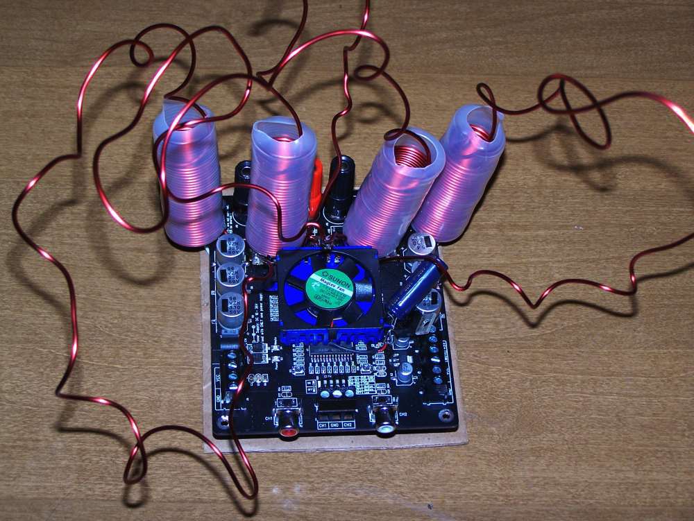

Thanks for the links guys, I've ordered some enamelled 18AWG wire, and hope to give the aircores a go soon.
I've already got my shielding, I found an old coffee tin was a perfect size for this amp:
Very cool coffee can. So much better than a $30 project box from an electronics store.

Indeed, I was looking at the current rating for 18AWG wire and the current rating was 2A, so I'm agreement that bigger is better!
The coffee can works a treat, I've been using the amp a lot more now. 😎
The AWG current ratings are based on voltage drop, not heating, so we're talking about performance, not safety, which gives us some leeway. I doubt if I ever actually push 2 amps (70 watts at 36v) through the coil, but, no doubt, bigger is better.

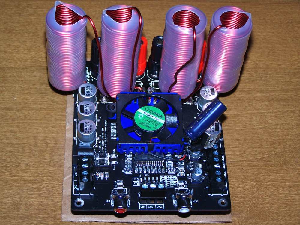

Coil Dispenser
So I had an idea of a way to hear the sound of every value air core coil from 10.5uH down. Start at the top and listen to the changes while unwinding a turn each time. Now I know that I want to concentrate on the values around 7.5uH which together with the .47uf and .22uf caps I am using, give just enough ultrasonic peaking to get out of the way of cymbals without throwing away too much suppression of the 650kHz emissions. Surprisingly, the 10.5uH air core cylinders were very quiet in the AM radio. No louder than any of the other cored torroids that I have tried. It must have been the ultra low 4uH value of my first cylinders that made them blast out the EMI so much more. 7.5uH is a bit louder than 10 but they are still acceptably quite even without a case. Should sound better and emit even less when I trim the loose ends. Add a dash of zobel and I may finally feel my filter is finalized. The values anyway. I still need to try to find a cheaper source for the Belden and also wind up some 12ga. 1/2 inch wide foil under teflon coils.
Sendler, we really appreciate the real-world testing you are doing and passing along to us. I'm glad you also observed minimal EMI/RFI with the 10uH coils, as I did. I thought I was doing something wrong in my testing.
Knowing that the EMI/RFI problems are negligible with 10 uH air coils makes them a no-brainer to me. They are cheaper than anything you can buy, take less than an hour and no particular skill to make (you have to be able to count to 22), and sound just amazing - even with cheap 18 AWG magnet wire.
I bought 100 ft of 18 AWG magnet wire on ebay for less than $10. It was enough to make 12 coils for my three amps with plenty left over. 12 AWG is about $30 and I'm thinking about it.
