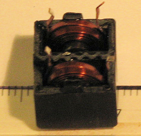

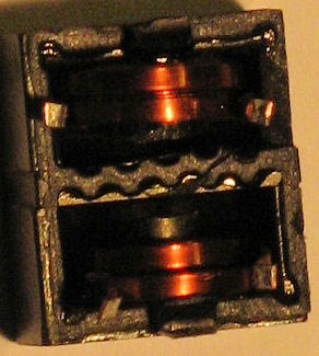

Toko, Sagami and Coilcraft all make "low-distortion" shielded gapped ferrites that should work as well as the Ferrocube core, or better. The picture isn't very good, but maybe you can see how this Coilcraft GA3416 is made. It's a dual inductor, so there are two identical chambers. Each chamber is an enclosed EP-type construction (see Magnetic core - Wikipedia, the free encyclopedia), with a 1mm gap on the center slug and flat "tape" wire. I haven't opened up a Toko yet, but I'm guessing it is similar.
Most of the Tokos, Sagamis, and the Coilcraft GA3416 ect, coils with 10uH values, are too small for a TK2050 amp. We need something closer to a 10 amps rating. I have the Coilcraft SER2915L-103 installed and they sound pretty good but have some blurring of the top octaves compared to the Ferroxcubes. Maybe ok for the woofers. I'm still hoping for something better off the shelf.
