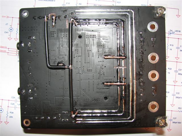

The extra regulator and cap are a hoot! I was waiting for my on board regulator to burn up... get hotter n hell!
I use a floating preregulator in front of the board that
a) takes away most of the heat and can be heatsinked separately and
b) works beautifully to bring down the noise to the level I find on the ground rail
Schematic is attached: the top bit is the prereg and the lower bit is the mod on the board where I basically replaced R2 and R3 by LEDs, a cap and a 470 Ohm resistor.
Also attached is a picture of the mod I did on the wiring to bring out the power supply for the regulator separate from the power supply of the driver chips.

The TC2000 driver chip is fragile to pops or mistakenly hi inputs. There is a protection zener across the inputs of the Sure but most of us have removed it for a slight improvement in sound. Tripath claims max inputs of 2.5v or beyond can damage the chip. This is way beyond full power from the amp so no one would intentionally crank their pre up that far but accidents happen. Sure is just warning you as to the failures they have seen so your mistake doesn't have to become their problem when the amp blows on the first power up. A tube pre can put out 10 or 15v when cranked.
