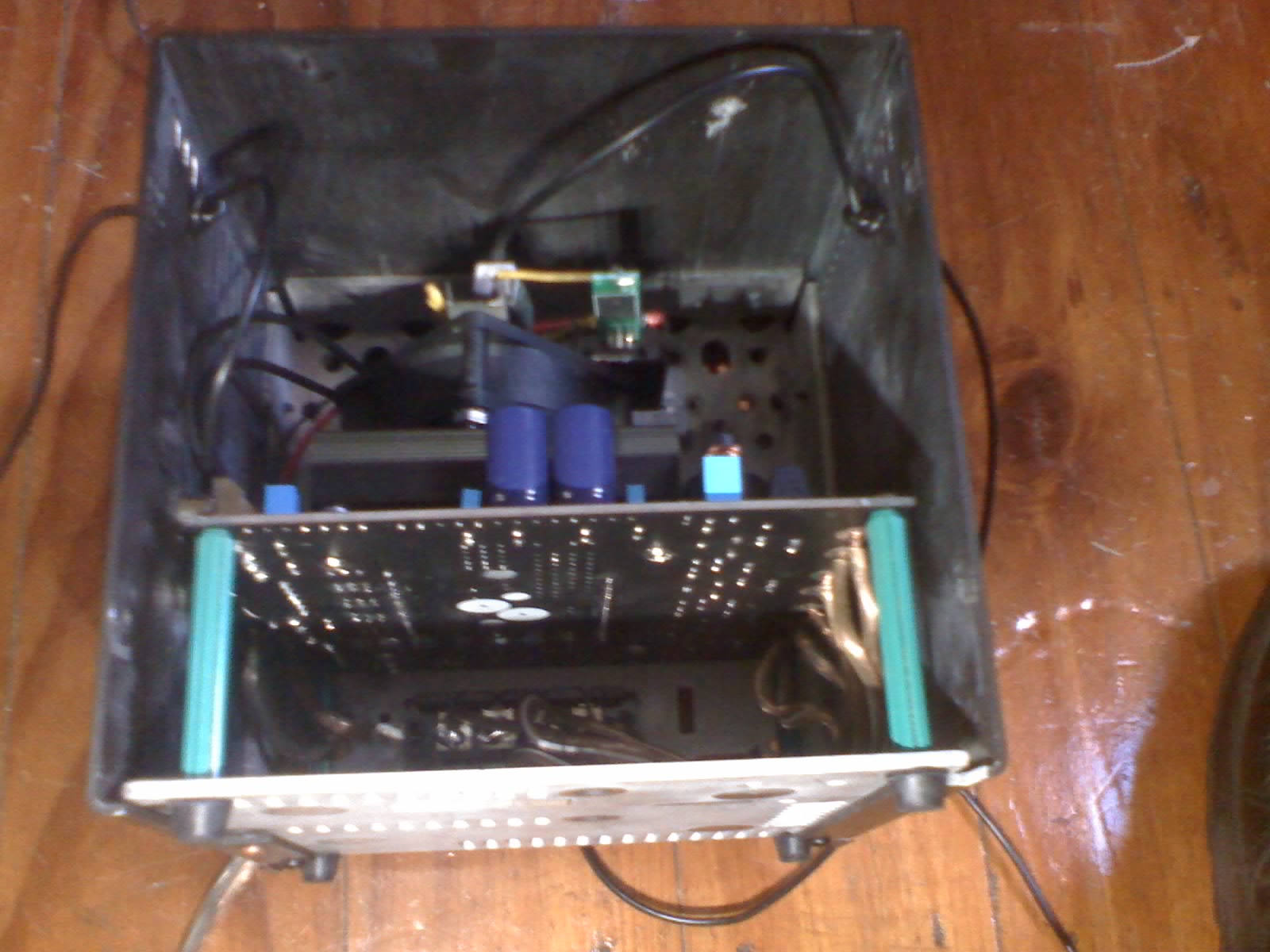

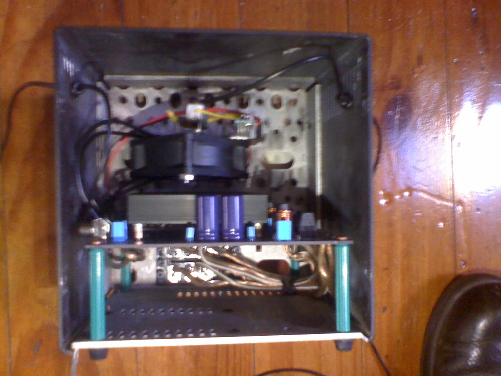

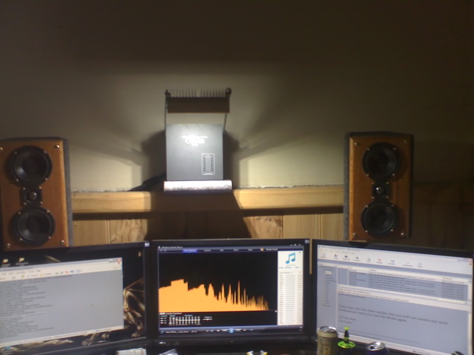

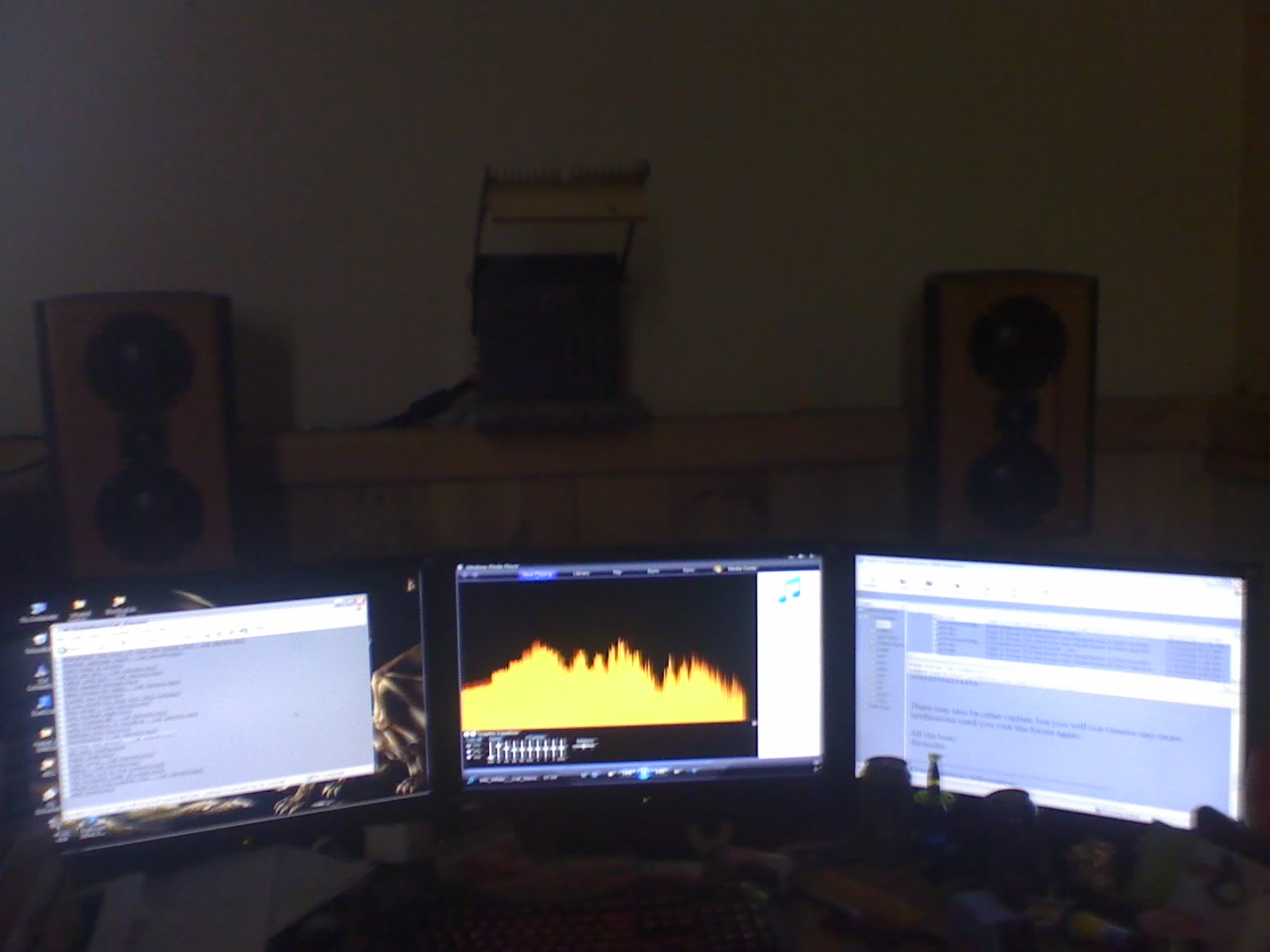

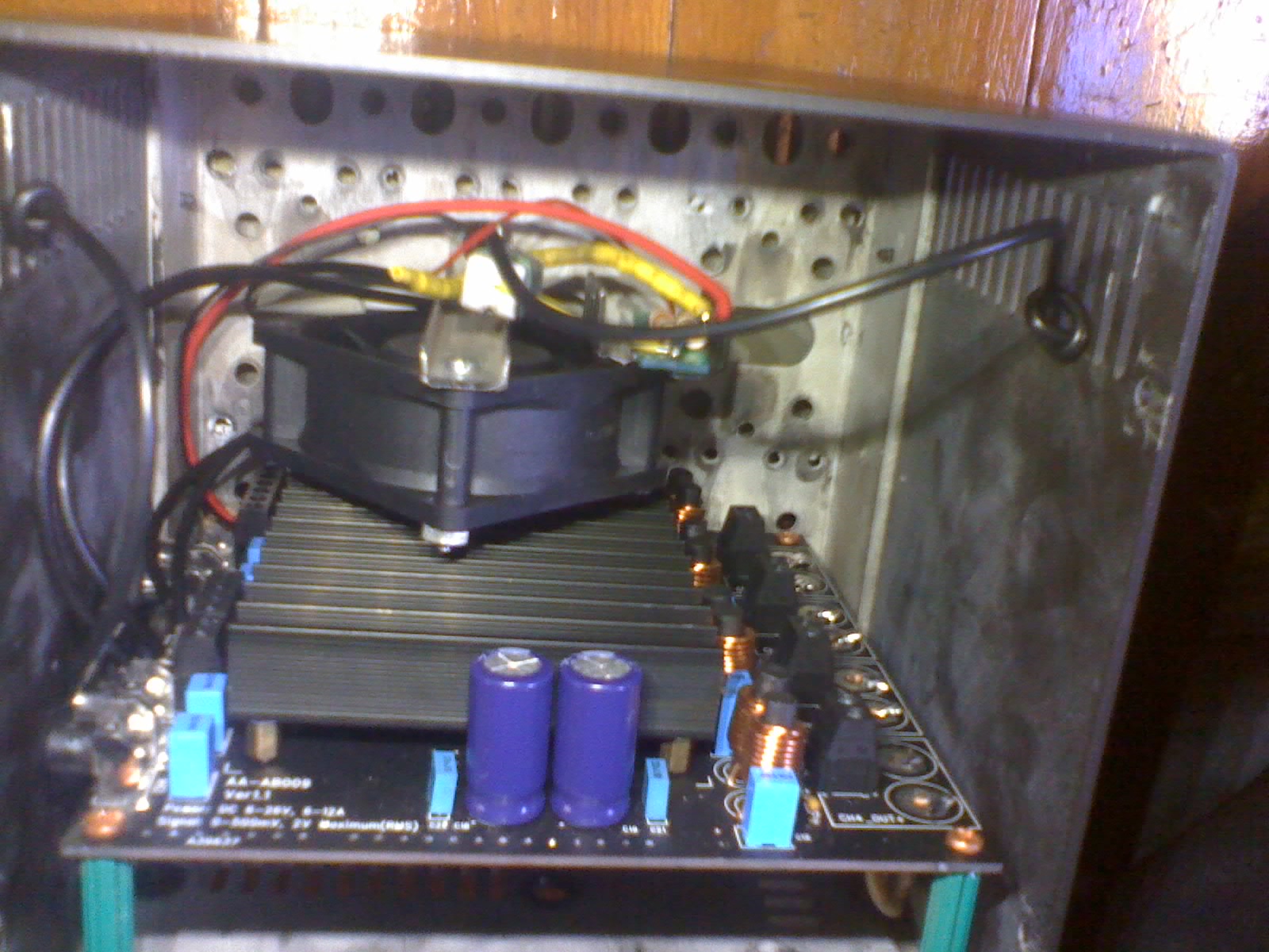

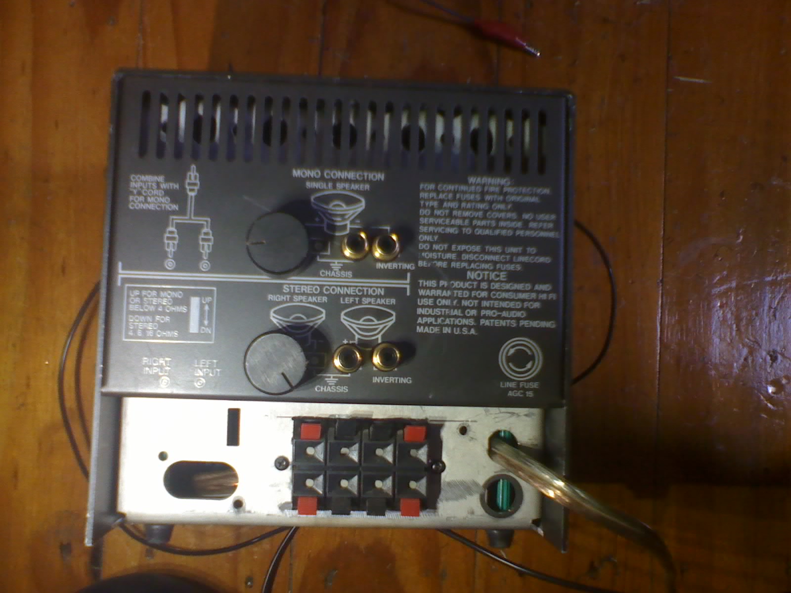

Start again. Here is my build of the Sure 4*100 board in a Carver M400 chassis. I bought two of these off ebay as not working. They certainly were not working but at the price they were cheap enclosures.
This build was for my computer desk and I incorporated a desk light with two 10W LEDs at 500 Lumens each.
Terry

Thanks. I don't know if Sure read this but if they do they should consider putting a fan on the 4*100 as they do for the 2*100 and have a small nice enclosure made that is perhaps a bit different. It is sort of nice being able to have a nice tiny amp that can run from a meanwell supply as well as a car battery, just the thing for a party where there is no power. The form factor is great.
Incidently, I am running the 12V fan on 8V. Can't hear it at all.🙂
Terry
