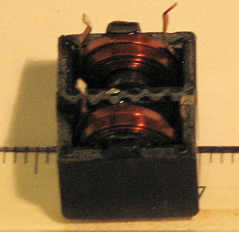

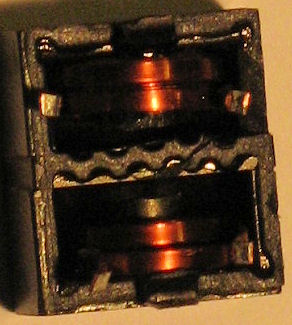

Toko, Sagami and Coilcraft all make "low-distortion" shielded gapped ferrites that should work as well as the Ferrocube core, or better. The picture isn't very good, but maybe you can see how this Coilcraft GA3416 is made. It's a dual inductor, so there are two identical chambers. Each chamber is an enclosed EP-type construction (see Magnetic core - Wikipedia, the free encyclopedia), with a 1mm gap on the center slug and flat "tape" wire. I haven't opened up a Toko yet, but I'm guessing it is similar.
So the dual coil package is just for miniturization to fit two coils onto one footprint? Or is there an electrical/ distortion advantage for balanced amps depending on how you wire up the phase of the output legs?

And yes, I think the dual coils are completely independent, for two-channel use or for common-mode filters where two coils are used on the output. (But I don't know for sure.) So they save board space.

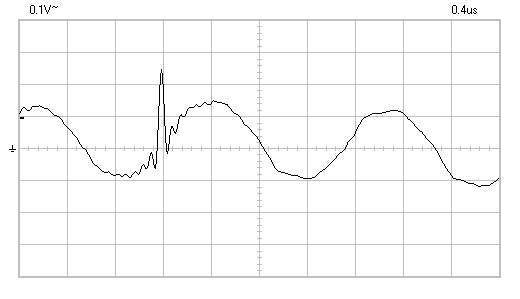

Nasty Waveform
I've just started playing with the amp and thought I'd have a look at the output waveform on the scope. At normal frequencies it looks like music but with the input shorted and the scope set as per the picture the output looks like this.
The sine wave is continuous at about 650KHz with the spikes occasional. Power supply is a Meanwell set at 32V on the board.
My amp doesn't have the Zoebel components.
Is this normal for a T amp with a SMPS? Are the speakers going to be happy?
Regards
Peter
