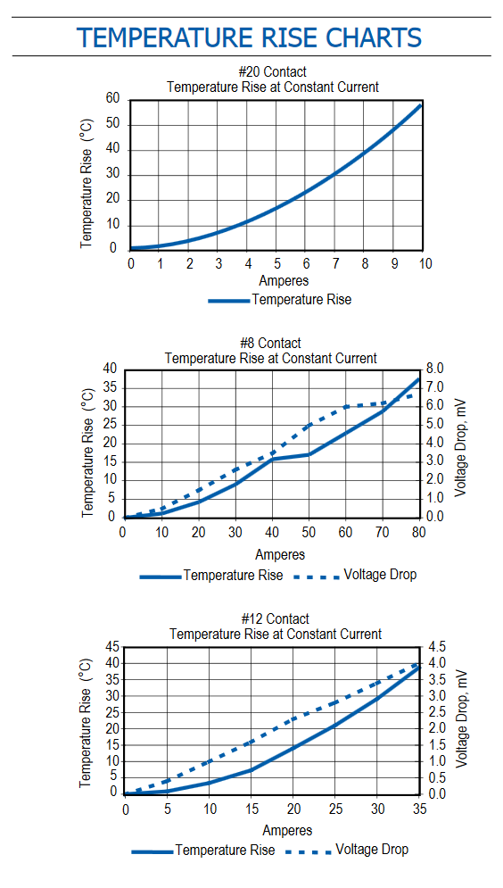

Uhm, sorry but the rating is for the maximum current, not the average and they were quite generous at the rating. I haven't found the exact same datasheet but similar types state the 25A are only the rating if heating up (because of the contact resistance) to 50°C is allowed. Standard rating (30°) is between 10 and 15A, depending on the connector type/how many pins are used (2/3).
The choice is still better than powercon because it's can result in a lot more damage and harm to plug in mains voltage instead.

Well, here you are:
These are pretty much the same (internally) as those plastic ones i posted, just with a different locking mechanism. Due to the one-side locking i suppose them no to be that watertight and vibration proof than the plastic ones which got screw locking.
Yes, they are. And they got a bit more realistic rating of 20A instead of the inflated rating of 25A. But they are 4-pin and not 3 or 2. More pins means more diameter if used parallel. Which translates to higher effective current rating. I didn't think I'd have to explain that, you know that very well yourself. Why are you mad and petty? 😕
