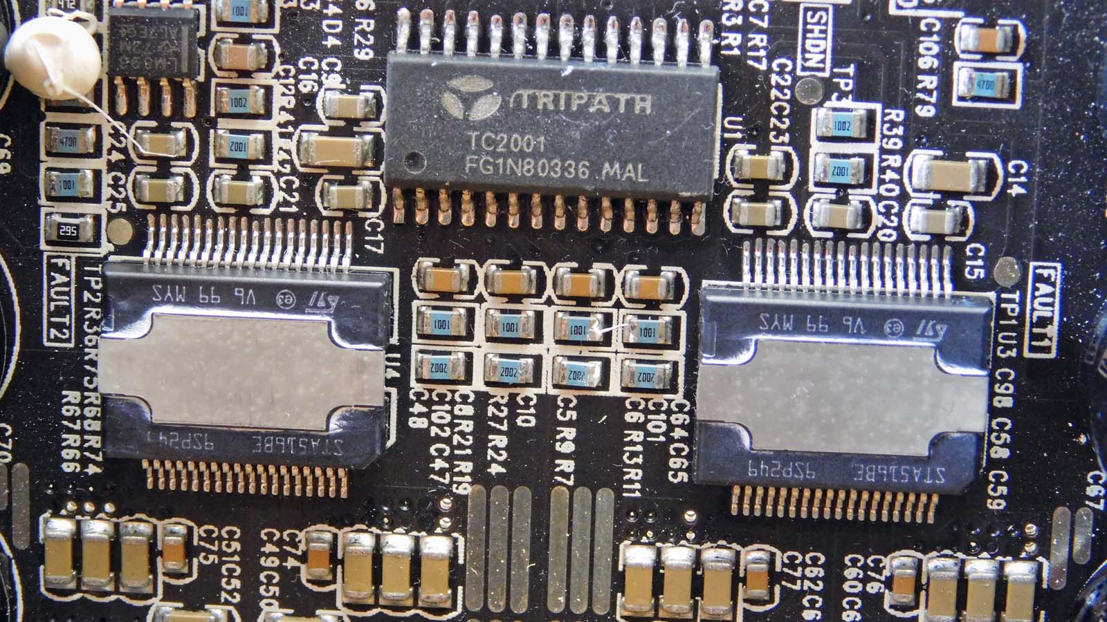

Knowing this, would you gamble? My board went dead suddenly.
I wrote a mail to sure asking for advice. They said most probably the driver chip (TC2001) is defective.
Well... good luck replacing it with one DoneVK was mentioning.
There are better options nowadays in the same price range.

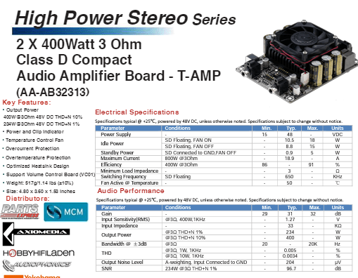

This is an old thread but I'd like to compare with other Gremlin owners.
Wanted to check if I could power a sub with enough headroom, I made some measurements on my AA-AB32313, to check out max power at clipping and max input at clipping.
Test has been done with a 4.7kOhm resistor and a 200Hz sine. SMPS is a Meanwell LRS350-36 running at a steady 40.8V
And now I understand I used to find it a bit limited for high volume listening.
Max input at clipping = 140mV! Max output is 4.8V.
Not surprising it was a bit weak...impossible to go full scale at 707mv RMS, it's clipping at not even 5Watts.
Is it normal? Could it be linked to the 40.8V instead of recommended 48V ?

The power supply voltage should limit the maximum output, but it should be independent of the clipping that at 140mV sounds too low. How are you measuring the clipping and monitoring the voltages?
I first measured with an AC voltmeter with a 50Hz sine, then verified that the result was the same on a sufficient range (the measurement stays the same till 5KHz).
Finally chose 200Hz to be where most energy will be. For the clipping I'm relying on the red led. If you push just 1 ot 2 db more you get terrible distortion ( just like an AM radio in-between frequencies )
On the other hand if the AV preamp outputs a standard 0.7V RMS at fulll scale (0db), knowing that the clipping occurs at -13 db, that's a bit more than 12 db so more than two doubling of voltage => 0.7 / 4 = 0.175 so 0.14 doesn't look so weird.

I run through a similar problem, in my case I was using another amp in the family (AA-AB31511), basically the same pcb in PBTL with different gain and sensitivity and a different voltage requirements
At low input voltage the unit was blinking the clipping indicator. Mine was a 500W x1 supposed to peak at 1.7 V rms. I tested mine with a test signal, all the way from .9 to 1.5 Volts and monitored the current used by the amp with 24 and 40 Volts power supply
this is my exchange with sure/wondom where they claimed the red light is not a clipping but a "power stage "indicator. after that I relaxed, sadly, and accepted these were the limitations of the unit, that they are not as sated. I never was able to get close to the rated power or maximum amperage used or using the unit without the clipping indicator blinking. I am including question and answers from the email in 2017 (I just removed email addresses and names).
QUESTION
I just received an amp from you, the sure AA-AB31511 some days ago. I have tested the amp with 6 ohms speakers and 4 ohm speakers (dayton DCS380-4). The unit has a hiss when it comes up and stays on all the time.
What concerns me is that the unit seems to be out of specs power wise. I have tried generating test tones at different frequencies, such as 50, 60,100 Hz and 50-250 Hz sweep, using the 4Ohm dayton subwoffer driver, the max current I can get out of the power supply before the clipping light starts to blink is 2 amps. Since this is a 40 Volt power supply, and taking into consideration that according to TI the amp should have a efficiency between 90 to 95, and the power supply is 40 volts, that is a 70 watts average before clipping. I have run the test also at 24 volts and with different source inputs, with and without the volume controller and in all circumstances the amp will start to clip (red light turns on) about 2 amps. When using 6 ohm speakers, the clipping commences about 1.5 amp, so it is basically the same rate once corrected for impedance
According to sure, the max output of the unit should be 350W@3Ω 50V DC THD+N 1%, that is about 7 amps at 3 ohms and about 5 at 4 ohms, aka 262 watts. 70 watts is very far from 260.
So, is it normal that the clipping of this unit starts at 2 amps, 70watts, and that has hiss with no input (on full range speakers, both at 6 ohms and 3 ohms). I am wondering if this power numbers (70 watts with no clipping) and hiss is the normal rate of this amp or if I have a bad unit
WONDOM ANSWER
Dear User,
Thank you for your mail.
1. The red light is not for error indicator but for signal level indicator, which means it will be lighting when the amplifier comes into the power stage.
With power higher and higher, the red light will change to a brighter color.
2. When its current is 2 A, there’s no clipping and the power is still
Getting higher.
Thanks for your asking and we will increasingly update our data.
If you have any question, please kindly feel free to contact us.
Best Regards
Customer Service
Input Sensitivity(RMS) | @3Ω,500W,1KHz | - | 1.3 | 1.8 | V |
Power Supply | - | 15 | 50 | - | VDC |

Power can no way be 2x400w and they are not even lying about that, the gain is published and is 30db, which means 128W at 4Ohms and 64W at 8 Ohms for 0.7V Rms signal, rest is headroom.
Of course 5W is another story...
