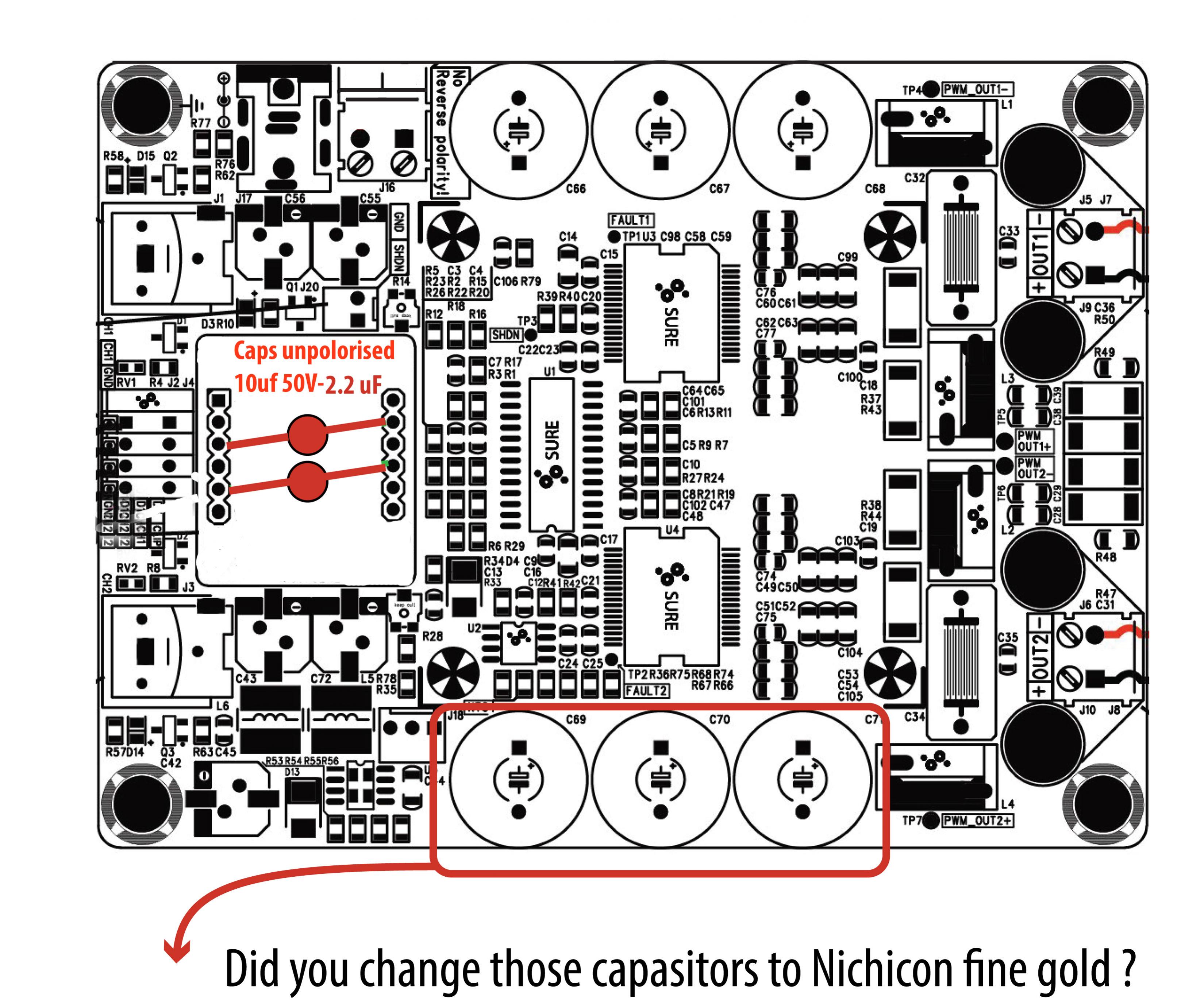

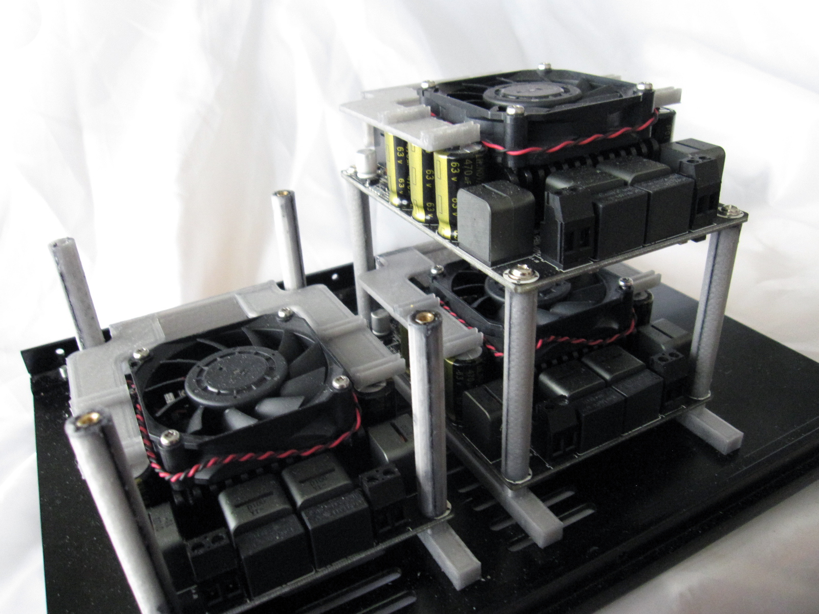

At the moment building 4x AA-AB32313 amp rack for active speakers in quite slow paste 😀😀.... waiting for capacitors to arrive,
In a photo platform beside fan it is a place for it.
Did you change those capacitors like in my drawing ?
It is not too late for me to do it. What values for Nichicon capacitors ?
Nichicon fine gold, which provides a better bass and dynamic

@gin8330
I did not change anything, just add 2 capacitors on each side of the pcb.
@chermann
you're right, I did not check the ESR because they are 50v capacitors that I had on hand for another project. You know better than me, if you have suggestions, it will be appreciated by all.
