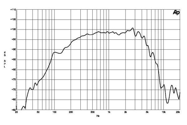

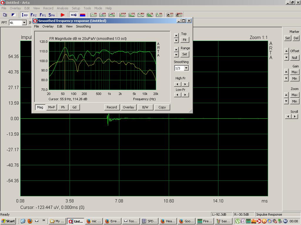

Here's the measurments of the pr170mo I have taken close miced. its perfectly flat from 400hz to 6khz where it crosses to a supertweeter. The green line that is
If you believe the plots is better option would be an old AUDAX HT210T0.
But I was alarmed always the case when a very low price. Very Low!
I always think about cheese in a mousetrap))
As for pr170mo then it is better pr170Zh0. But the first and second have not enough wide range for my goal, and a very fast roll off!
