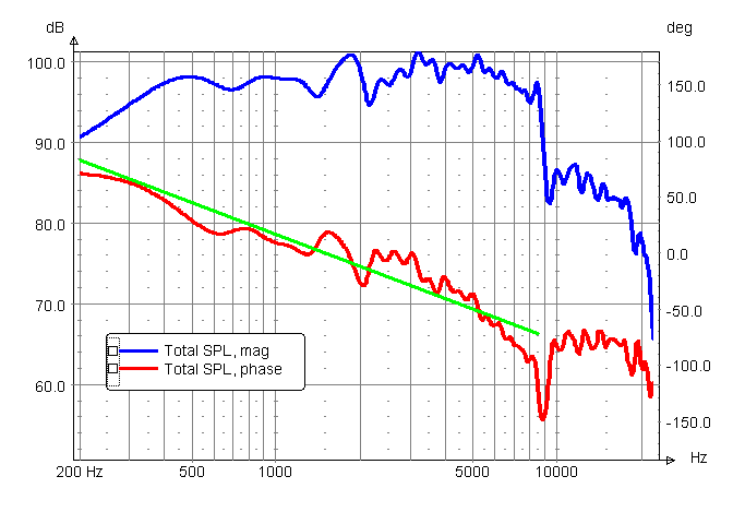

This graph is a lot more honest, and even it doesn't show the problems with the surround at 1.4 kHz:
(..note that the coated (nextel) version of this driver will help smooth out the upper band ripple, part #PR170N0).
Well, well, honest. Ask about it Rainer of Proraum Vertriebs-GmbH | Startseite
He said that what measurements were made as follows: "There are so many idiots around and that was done in 1993... young
engineers from university, NO practical knowledge 🙂
And due to the wrong parameters of course.
What I measure here is perfect! We control regularly."
..well, at least the 25*21* is far more linear.

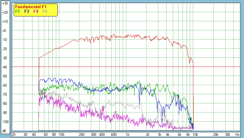

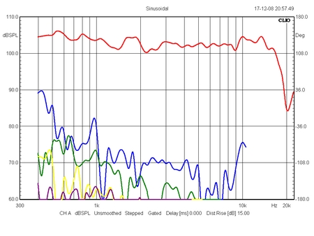

Also look at its non-linear distortion.
Finally, look to the off-axis performance in relation to something like the PHL mid that Zaph measured.

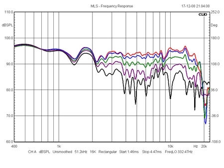

Here (Supravox RTF 64):
(..note that off-axis and distortion measurements here include the cone tweeter, and are still poor by comparison. Off-axis on the 3rd graph only represents 0,10,20,30,& 40 degrees.)

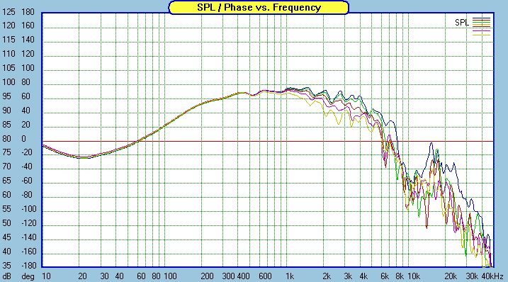

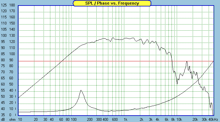

Vs. (PHL):
(Off-axis extends to 0, 15, 30, 45, & 60 degrees.)

With respect to that, look at it in relation to the PHL unit (..where we actually have an absolute comparison).
Even the PHL has a -4 db at 2.2 kHz.. but the overall average is substantially better.
As for non-linear distortion it's not even close, the PHL "walks all over" the Supravox.
Finally there is the issue of off-axis performance above 2 kHz. I don't know of a large high eff. mid that is better than the PHL's that extends usefully higher in freq..
