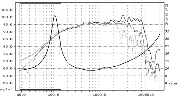

I like full range drivers. Will be better if midrange start from 120 Hz, but.... more really and no big compromise 200-250 Hz. Interactive Frequency Chart - Independent Recording Network

the audax is suppose to be able to go down to 300hz, but in my setup, its at 400hz that it starts to roll off.
I see alot of purist, Dave from planet 10, that accept to let their woofer play up to 400hz, I trust them mroe then a chart.

I think that I made a choice. I think that for my goals this will be the best set 2 X 12 AE SBP in sealed box + LT + 2 X Supravox 165LB + Beyma TPL 150 in a sealed box. Speaker size turns out huge, more than 160 cm height, but After all I used to think, and my Zu 120 cm huge growth as well, but now everything is familiar))
