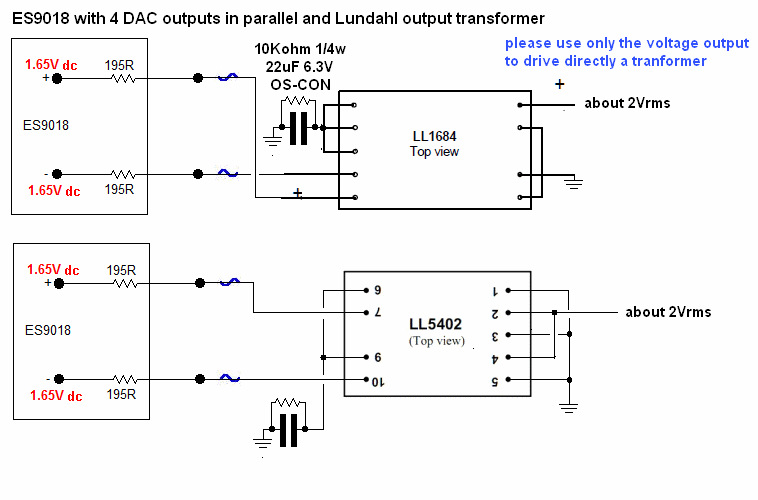

I'm very curious about 1k R1 and 3nF C1. In the board's photos I can see this R1 on the board, and not the C1. Yes, you say that this 3nF is not used. But in the schematic, we can see that R1 and C1 are serial connected. Then, why are R1 welded in the board?

I have 2 LL5402 want to use super I/V pcb board,besides the different connect (in accordance with attached file that Quanghao support),the other component (c2,r2,c4,c5,c6/c8,c9,c10,c1,r1) are still add in PCB?
Because attached file only list 1 cap and 1 resistance.
Please help me,thank you.
axeexa
