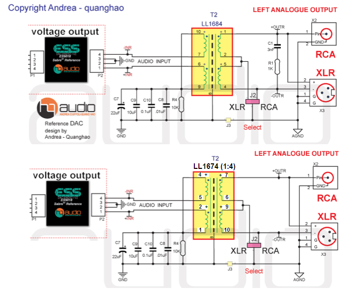

Sorry , but if i understand well, in this case i have a 4 : 1 transformer and not a 1 : 4 transformer for more gain.
I want to use LL1674 or LL1676 (1 : 2) in your dac converter.
LL1684 = 1:1 / Prim dc = 41 ohm/winding / Second dc : 41 ohm
LL1674 = 1:4 / Prim dc = 33 ohm/winding / Second dc : 605 ohm
LL1676 = 1:2 / Prim dc = 145 ohm/winding / Second dc : 605 ohm
Br
Jacky

Hello Guang Hao,
If i am not mistaken , connections are like this with LL1674 :

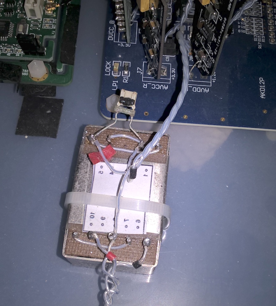

Vishay VAR-Series "naked" 18 ohm parallel to the output, then:
Lundahl LL1941
Trafo must be loaded by a reasonably high impedance (>25k)
Works very well.

Hello,
So , i understand well, ES9018 works in current mode , but output must be very low at the primary and gain partially offset by the output transformer ?
Could you give us some voltage level in this case ?
Br
Jacky
The caps and the resistor in the primary side of the transformer as per kmajjo diagram form a low pass filter, this way you wont put subsonic frequencies in the trafo and create distortion 🙂
Since amorphous core transformers are very sensitive to dc offsets(if you apply a dc voltage across any of the coils you can magnetize the core and after the transformer will produce distortions) I don`t reccomend that you use in place of this filter a short wire to ground. LL1674 and LL1684 are amorphous core transformers.
There is another thread here where Joe Rasmussen presents some interesting things that you should check.
http://www.diyaudio.com/forums/twisted-pear/164294-buffalo-ii-transformers-19.html
See from post 185 and after.
I am using my es9018 with some LL1684 in the output connected as per diagram C in post 185 in the link above and the combo sound very good.
