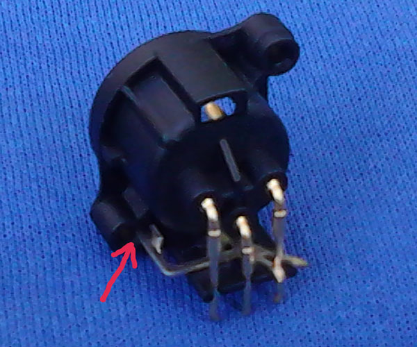

Another technical question please:
I see on the Neutrik XLR socket that the lower mounting hole is electrically connected to pin 1,
so when the Neutrik is attached to the rear chassis with a screw, pin 1 is then connected to the chassis -
that's all fine and correct for balanced output connections ...
... but on the PCB pin 1 of the XLR socket is also connected to RCA ground - thus RCA ground is also (permanently) connected to the chassis.
I thought that unbalanced outputs were supposed to have floating grounds. Is this correct ??

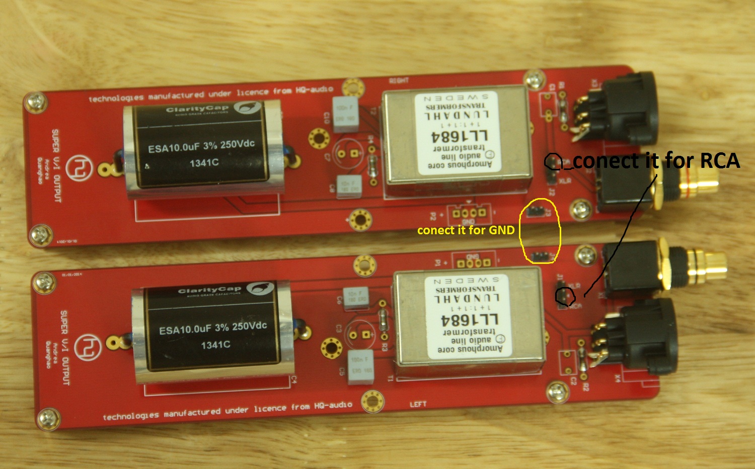

please see image for your conect GND and RCA out
Yes, I see the correct jumper-connections at J1 and J2 for RCA output, but my question remains:
the RCA ground is permanently connected to chassis via pin 1 (and the lower mounting screw) of the Neutrik socket.
Is it correct to have RCA ground to chassis?
HI!
pin 1 of Neutrik, it is GND , only conec to the GND of DAC
You not connect direct to Earth of Chassis.
Please conect GND of DAC to Earth of Chassis.
That i see your question ??
thanks
Sorry, I'm not understanding you. As I read your comments, they seem to contradict. Maybe words fail.
There's a small metal bracket which connects pin 1 to the inside of the mounting hole. Once a screw is inserted from the outside of the chassis, a connection will be made between chassis and pin 1.
OK, this makes sense to me, but it doesn't agree with what I see on the Neutrik connector; photo attached.pin 1 of Neutrik, it is GND , only conec to the GND of DAC
