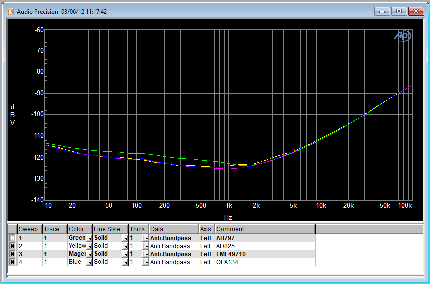

Q2. Why was the AD797 not the recommend op-amp?

In terms of noise, the AD797 still wins when compared to this cohort of operational amplifiers.

Both Walt Jung and myself repeatedly had issues with the 797 as to stability in this application. The 797 is a superb opamp and very low noise, it just was very hard to keep it stable. I have no clear explanation why this is so; it may have something to do with its unique internal structure.
