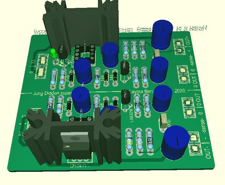

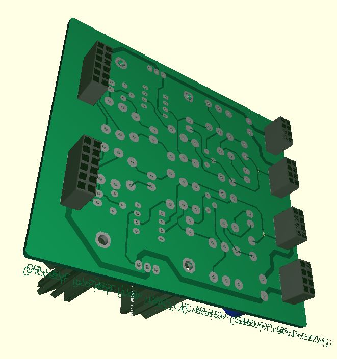

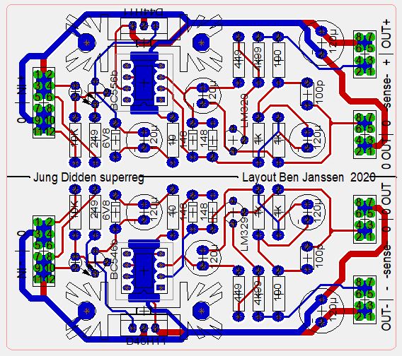

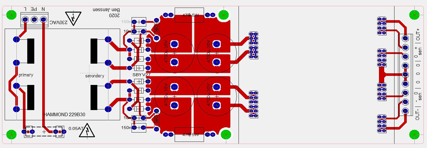

Jund Didden PCB layout review
Hello,
I've just finished the layout version1 of my preamp PSU with a Jung Didden superreg which can be assembled using pin headers.
I've followed the original schematic, except for the input electrolytic. As the superreg PCB is direct after the main cap's, I assume this cap has not any added value.
I connected the 0's of both the pos and neg superreg's to each other on the PSU PCB. This to create a ground start point.
Or would it be better to add the 0's together on the preamp (buffer) PCB?
Have a look here to understand what I'm willing to do.
https://www.diyaudio.com/forums/pow...erstanding-star-grounding-69.html#post6136959
Regards

Dag Jan,
Regarding post 1847, do you see any problems with the superreg layout?
For example, I connected the heatsink to ground and added a small ground plane underneeth the opamp.
All comments are welcome.
Groeten
Groeten

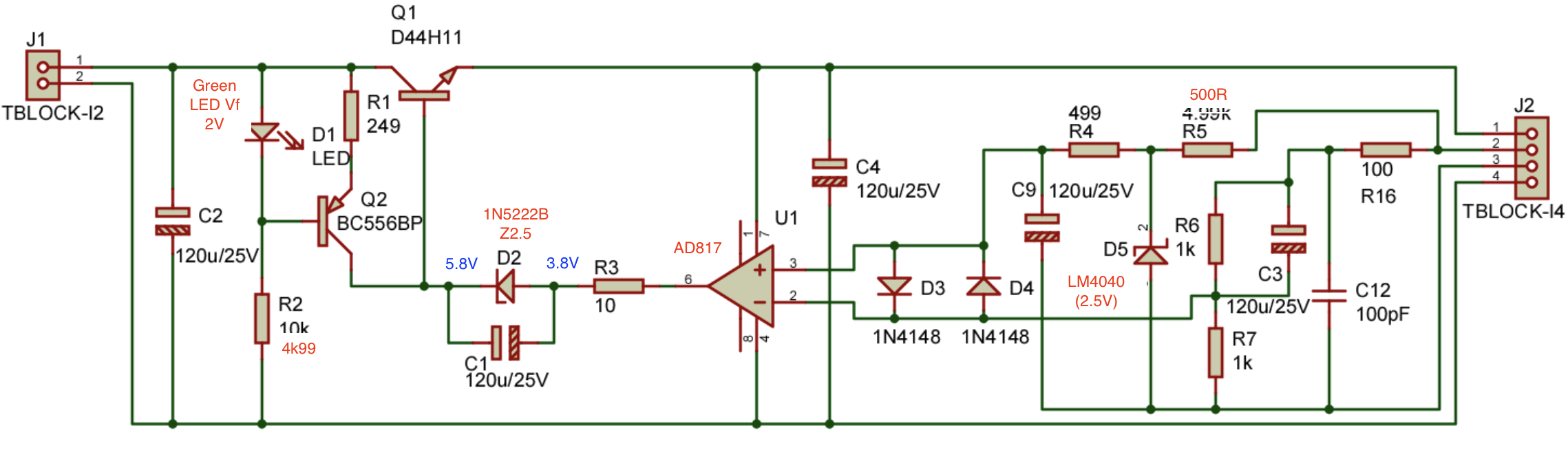

5V Regulator Current
Dear Jan,
I've built up a few of your regs using the DIY audio PCB in +5V form. Good news is that it works outputting a stable 5.24V. My issue and question relates to output current. I'm seeking up to 1A output but as soon as the reg hits around 750mA the output voltage collapses.
I've attached the circuit diagram with my 5V component modifications shown in red. I've also indicated the voltages across the zener at the output of the opamp when it's regulating at around 600mA. When the current draw increases I see the opamp output rise to around 4.2V but the other side of the zener only increases to 5.9V? (I expected to see 2.5V across the zener)
Wondering if it's something to do with Q2 not providing enough base current to Q1??
Your guidance would be much appreciated!
Best regards,
Bruce

You can try to increase the current source a bit.
An easy fix is to replace the pass transistor with a Darlington. You need a bit more input/output difference, and check the heatsinking, but 1A+ should be easy.
In your case, all current from the current source goes into the pass device, and the opamp basically stops sinking current, which means there is no or almost no current through the zener, thus the lower voltage.
Jan

My reckoning is that the current source is set for (2-0.70)/249 = about 5mA. Looking at the data sheet the BC556B can do Ic 100mA continuous - so lots of headroom?
So would see you any harm in going for say 100R source resistor == 13mA source current?

Don't forget that the opamp must be able to absorb all of the current source current to regulate at light loads. So don't overdo it, maybe double it, that should give you enough headroom.

Tried 10mA and that was marginal.
After looking at the BC556B and AD817 data sheet I've increased the current source current to 20mA as that's well below the +-50mA source / sink rating of the opamp and my load will be constant around 500mA.
Works great now! 2.5V across the zener and stable.
