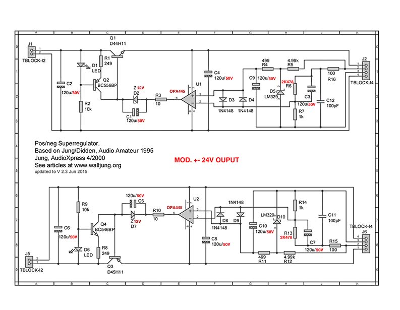

Modifications to get stabilized +- 24V output
Jan, could you tell me what modifications I should make to get stabilized + -24v output.
I want to use the super regulator to power the BA-3 front end.
regards.
regards.
You use the voltage drop over the LED so the only thing you should be aware about is that the minimum input voltage to the regulator will be increased if you use a blue or white LED. All other colours will produce 1.6 to 2 volts.The green LED can be any green LED or an specific brand and model?
regards.
If you use the 6.9V reference as in the article, to set Vout to 24V you need to adjust the ratio of the two feedback resistors at the neg input. They should provide also 6.9V with 24V at the output.
The other thing is that the zener in series with the opamp output should be nominally 12V or thereabouts (anything between 5V and 20V will work, the idea is to keep the opamp in its working range).
Jan
Jan, is this modification correct for 24V output?
MOD FOR OUTPUT +- 24V
LM329 = VRef. 6.9V
24V – 6.9V = 17.1
17.1/6.9 = 2,478260869565217
R7 - R14 = 1K
R6 - 13 = 1K * *2,478260869565217 = 2K478
OR
R7 – R14 = 2k
R6 – R13 = 2K * *2,478260869565217 = 4k956
LM329 = VRef. 6.9V
24V – 6.9V = 17.1
R7 - R14 = 1K
OR
R7 – R14 = 2k
