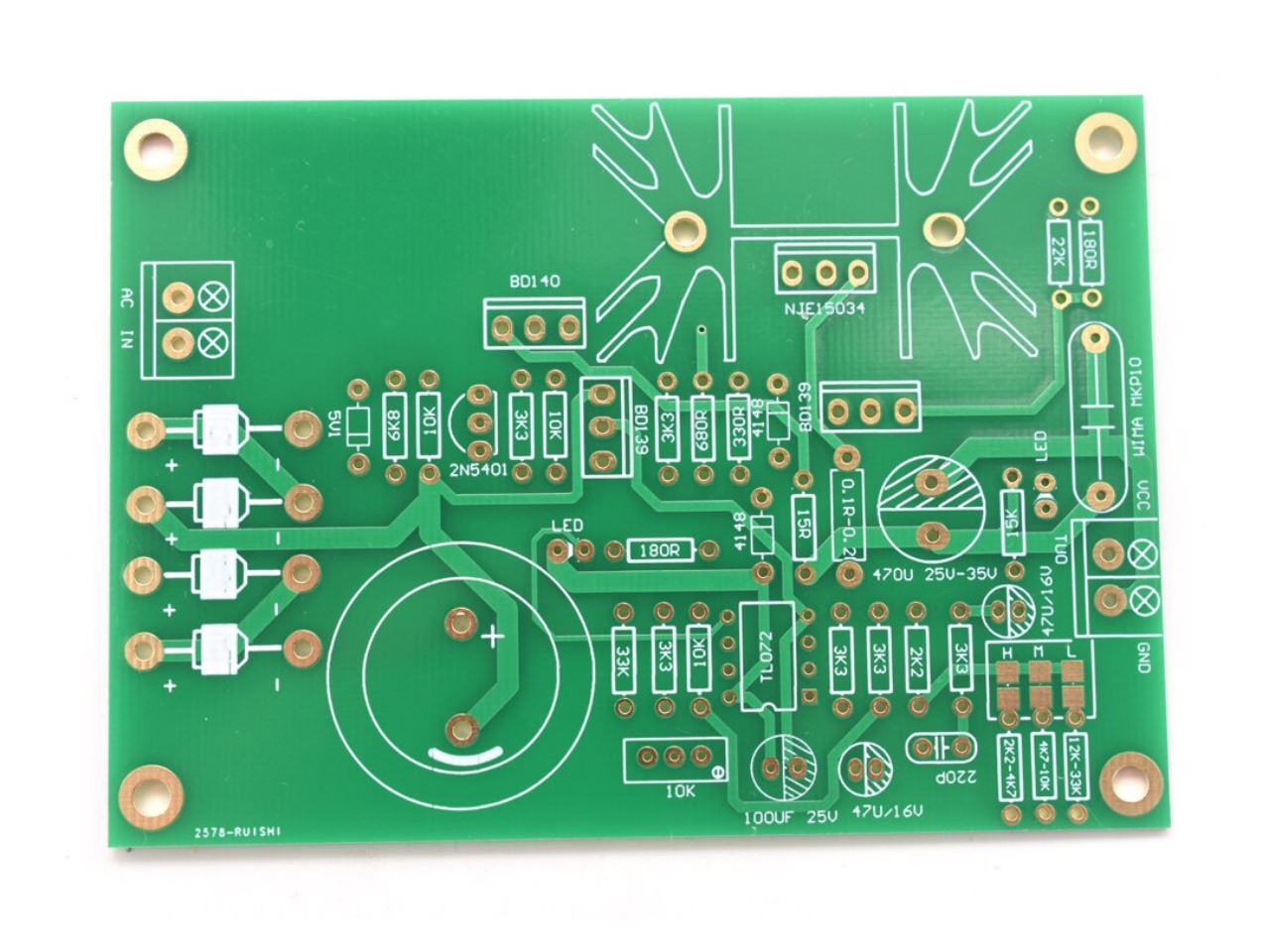

I have a question regarding proper load capacitance of superreg.
I currently built a 24V version (30V input with ad825) for garage1217 starlight, which has 2x 4700uf input filter cap. I noticed that the superreg is struggling starting up the amp, probably because those caps are too large. Also, it actually might stop working after maybe 10 minutes. The D44H11 is very hot.
I wonder whether I should reduce the input filter cap on the starlight. I originally put those there because I was using a different smps. I happen to have some 10/22uf tantalum and a bunch of aluminum caps around.
I will appreciate some insight into this. Thanks.

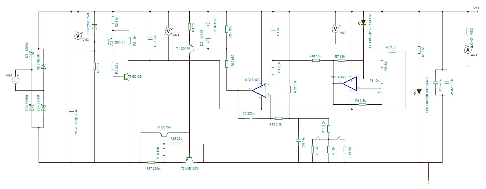

Anybody have a chance to compare Mr. Jung regulator with the regulator sold under studer900 tag. Regarding to noise and output impedance. Some users called it is better than salas regulator.

The D44H11 can take around 1 W without a heatsink so how much power dissipation do you have? (Load current x Voltage across collector and emitter)
P-A is right. If it stays (very) hot during operation is cannot be the caps. How much current does your garage draw?

6V at 300mA is 1.8W, which is not a whole lot but can raise the temp to above 40C. And 40C is a temp that you can just touch for a longer time so it really feels like too hot. Are you using the on-board heatsink for the Superreg? If so, I think you're OK for temperature, just be sure that there's some air circulation space around it.
The slow run-up may be due to the very large capacitors, they need time to charge and during that time the current is high. But it should be over in well under a second unless the transformer output drops during the charging due to heavy load.
But are you sure the current draw is 300mA, is it not more? I would measure the current first. Always measure, always diagnose before randomly making changes!
