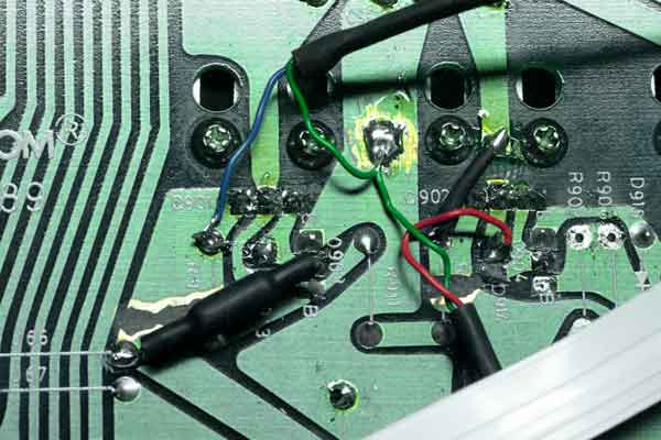

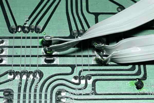

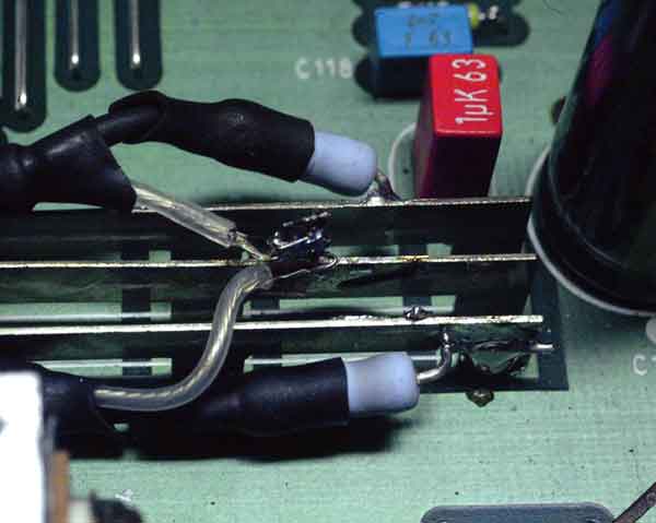

As an example: In my modified Adcom GFP565 Preamplifier I connect the Kelvin sense leads to the output buffer (LT1057) supply pins. This makes that position the lowest impedance nodes on the PCB.
(Come to think of it now, I should replace the Linear Tech buffer on the 565 with the new Texas Instruments BUF634A.)
I also have an SR in an ancient Crown IC-150A preamplifier -- same drill -- the output devices were, I think, LF353 -- now replaced with a compound amplifier.
Pix are from years ago:
