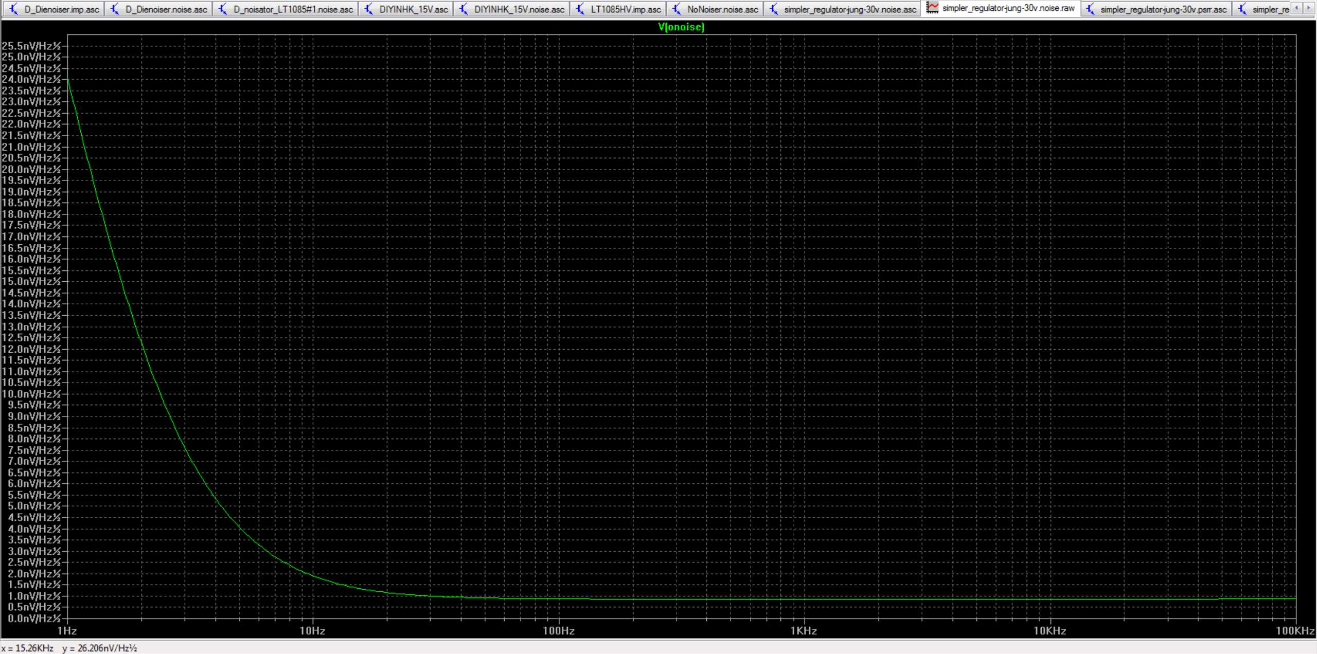

A question for Jan. First of all Happy New Year.
Is it possible and/or has been tried increasing the value of C9 in the Linear Audio official schematic, the bypass cap to ground for the non-inverting IC input?
In the simulations I have been running, it does seem to affect the noise curve considerably in the lower frequencies.
Unfortunately I don't have and AD825 LTSpice model, so I have been using the LT1115's. And I wonder how valid my findings might be then.
I'm aware of the "don't change anything" superregulator maxim, so I'm humbly asking if it has been tried and caused serious trouble elsewhere.
Transient analysis with the new cap runs fine, so actual trying on a pcb would be the real proof.

I think it also depends on how accurate the LM329 model is, because that's the noise you are impacting.
As you say, you can try it out, if you can measure noise. Instead of increasing C9 you can also try to increase R4, same effect. Up to 3 or 4k should not make a big difference on the output voltage.

Hi Jan,
Unfortuntely I'm not using an LM329, and would accept any LTSpice model anyone might have to try.
The one I'm using on my sim is an LT1634-5, that comes with LTSpice and should be reliable.
But I did try increasing R4 to 3K and 4K, and the improvements are quite good. How high can I go on it?

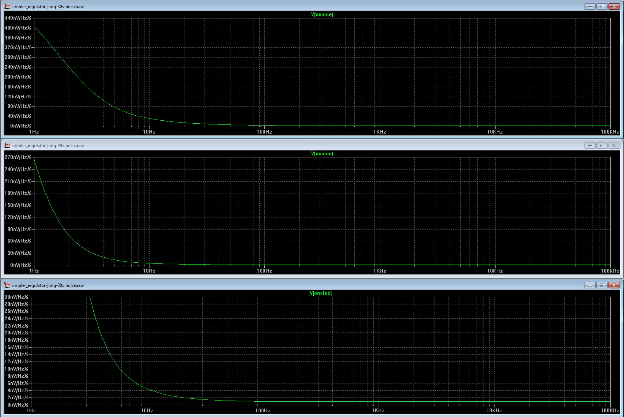

The values for R6/R7 for 30v output are 1K1/220, and I want to be as close as possible to 30v. Good to know about the 1/2W Dales for them. Thanks!
So you say I should use BZX55C 13 with series 1N4149 instead of LM329?
Those Christer's measurements are for the regulator's noise? The noise values I get on the simulations, as the curves show, are higher than that. You think the sim results are wrong?
If someone did simulate noise for the regulators on LTSpice and then measured the actual results, please let me know.
OK, I discovered I was doing things badly, because for my 30v the output zener should be half that, so I changed that one to a 15v zener.
Then, as suggested, I swapped my voltage reference also to a 15v zener. Then adjusted R6/R7 to 1K.
Now the noise curve got much better.
Increasing R4 value brings very little change, so I left it at 499.
The lowest noise I reach is 790uV. Should it be less than that?
