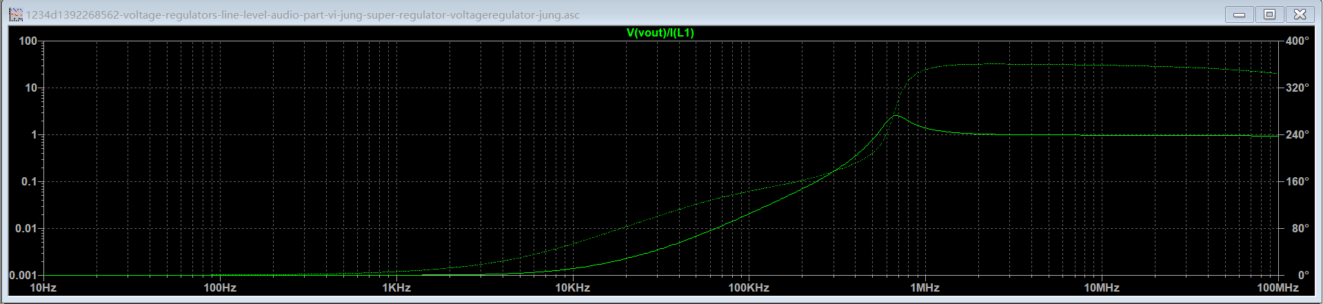

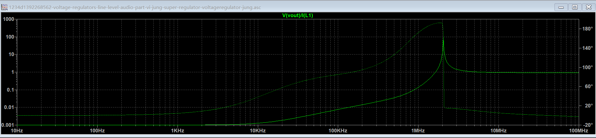

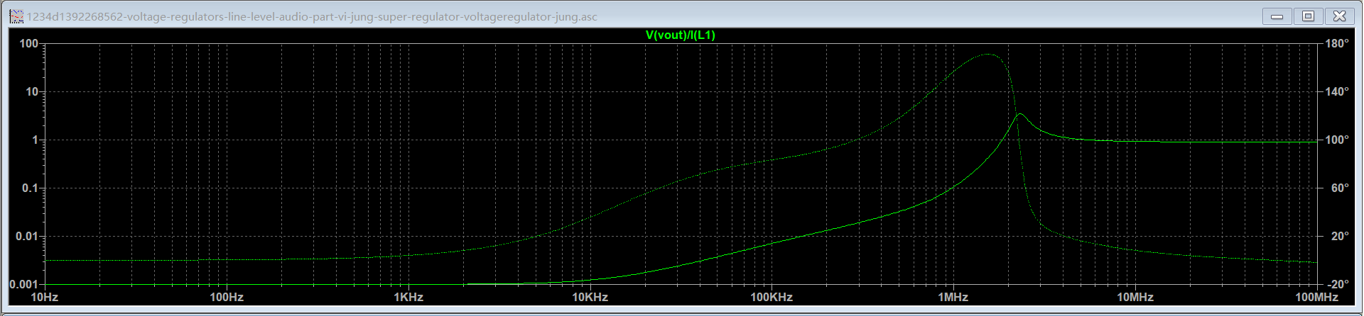

Have been playing with spice model for a sulzer style superreg; I did ac sweep with the current source load as the AC source, and plotted output voltage to see the load regulation.(not sure if it's correct, maybe the metaphysics probes are connected wrong, since its loop gain that should be shown here)
There is always a peak in the frequency response @ 2-5MHz, depending on the pass transistor used in simulation, and cannot be mitigated by tinkering with compensations like ESR Zero, bypass capacitor in the negative input of error amp. Using feedforward compensation caps at error amp even make this peak higher😕 adding a small resistor to the emitter reduces this peak to ca. 6dB, at the cost of worsen performance at low frequency.
Could anyone kindly tell me where the problem is?

Hello Mr. Jung,
1) No I didnt. Is Mr.Sulzer active in DIYA?
2) I am also aware that, by supplying the error amp and the Vref with regulated voltage from another regulator, the PSRR will pretty much at risk and the circuit itself is nowhere similar to your publication in 1995. Sorry if I am leading this post away again.😱
However, a Superreg with opamp rail supplied from regulated side seems to show "startup" problem in the simulation as well. By setting an initial voltage to the output capacitor it is possible to get a relatively meaningful result, but how much the simulation can compare to the reality in this case, is IMO
questionable.
Also, in some DIY posts it is mentioned that, the layout of supply trace to error amp has obvious effect over the stability. Combined with the post from Mark Johnson (about the positive feedback route from Vout to Opamp V+) I figured it is better to keep the whole design unsensitive towards layout technique.
3) 4) As Jan just mentioned, the error amp and the pass element shall have different BW in order to separate their phase shift from each other, will
gijve this a try. Personally I have already built some SRs according to the papers by linear audio and find the effects quite satisfying, did the simulations out of curiosity rather than blaming the original schematics🙂

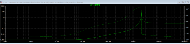

Of course Jan, there is currently a pair of em running in my headamp, nothing gets cooked😀. My point is, if the sw cannot model the stable state of the SR with reasonable accuracy, it then doesnt make sense to do any research based on such a questionable model.
Some results with LT1128 and several bjts coming with LTspice. The output Z also showed a peak, see attachments. That means instability?😕
BTW I send this sulzer style reg to one of my friends whos got Multisim, the "high impedance" range was even larger (with fzt857), rather than a peak it is now a whole moutain from 1MHz to over 100MHz...

The problem is probably not the simulation software but the models of the opamps and other parts. Different simulators may use different models in their libraries that may not be fully accurate - they are models, not the real thing!
You can check that: simulate a circuit shown in a data sheet and see if you get the same graph as in the data sheet. Sometimes it is surprisingly accurate, sometimes not at all.
Especially start-up issues are frequent in all kinds of circuits, because models are not good at modelling that. Perfect startup simulation would require much more detailed modelling (and also some more refinement in simulation, that is true).
Some models are so-called macro-models that model behaviour rather than internals and they cannot be trusted in unusual situations like startup.
Some manufacturers have two types of models: very detailed and accurate ones but encrypted for own use, and behavioral ones for 'us out there'. Guess which are most accurate.

1 Ans) Not to my knowledge, unfortunately.
2 Ans) Yes, you certainly are leading people away from the virtuous features of a true SR. 😕 But, whether you are totally aware of this or not, the circuit concoction you have shown still retains parts which are required within a true SR, but are totally redundant to the way you have things set up.
You should clean up that circuit by deleting R4, R5, D1, D2, Q2 and C2. R6 should be retained in a practical value, as it has a stability impact. It has been part of the SR architecture for some time. You missed this, apparently. Drive the Q1 base directly from the op amp, through R6.
Yes, it is possible to see what appears to be startup "problems" with certain op amp SPICE models. Jan has explained this. and why. Do absorb that, fully.
Be aware that some actual op amps have phase reversal issues with applied CM voltage. i.e., TL071 and early JFET input related families. In the end, the real behavior is what the actual parts do, not the SPICE runs. At least one real world example of this has been published, back in 1997 such as this 5V regulator. Read the details describing the differences in line rejection with the op amp powered from the output vs. the input. And, very importantly, read "Kick-start me, please!".
Alas, it can't be really be determined here whether you have done anything positive towards the alleged layout induced instabilities, sans a PCB layout actually showing this. 😡
Walt Jung

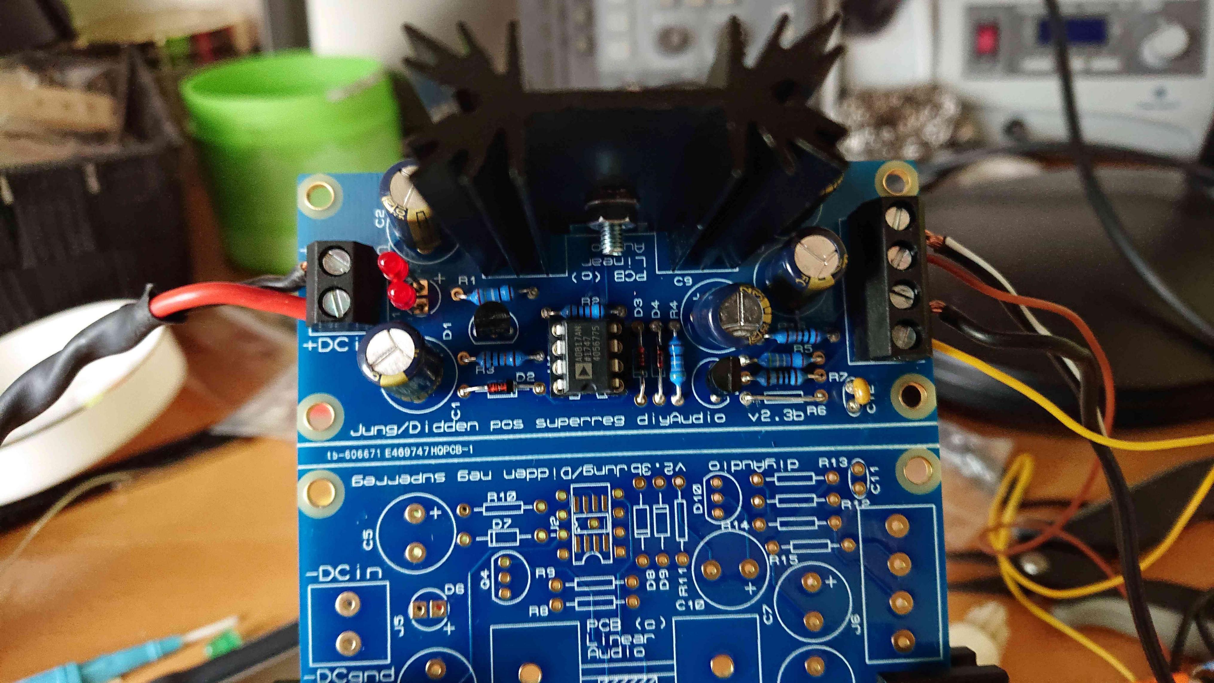

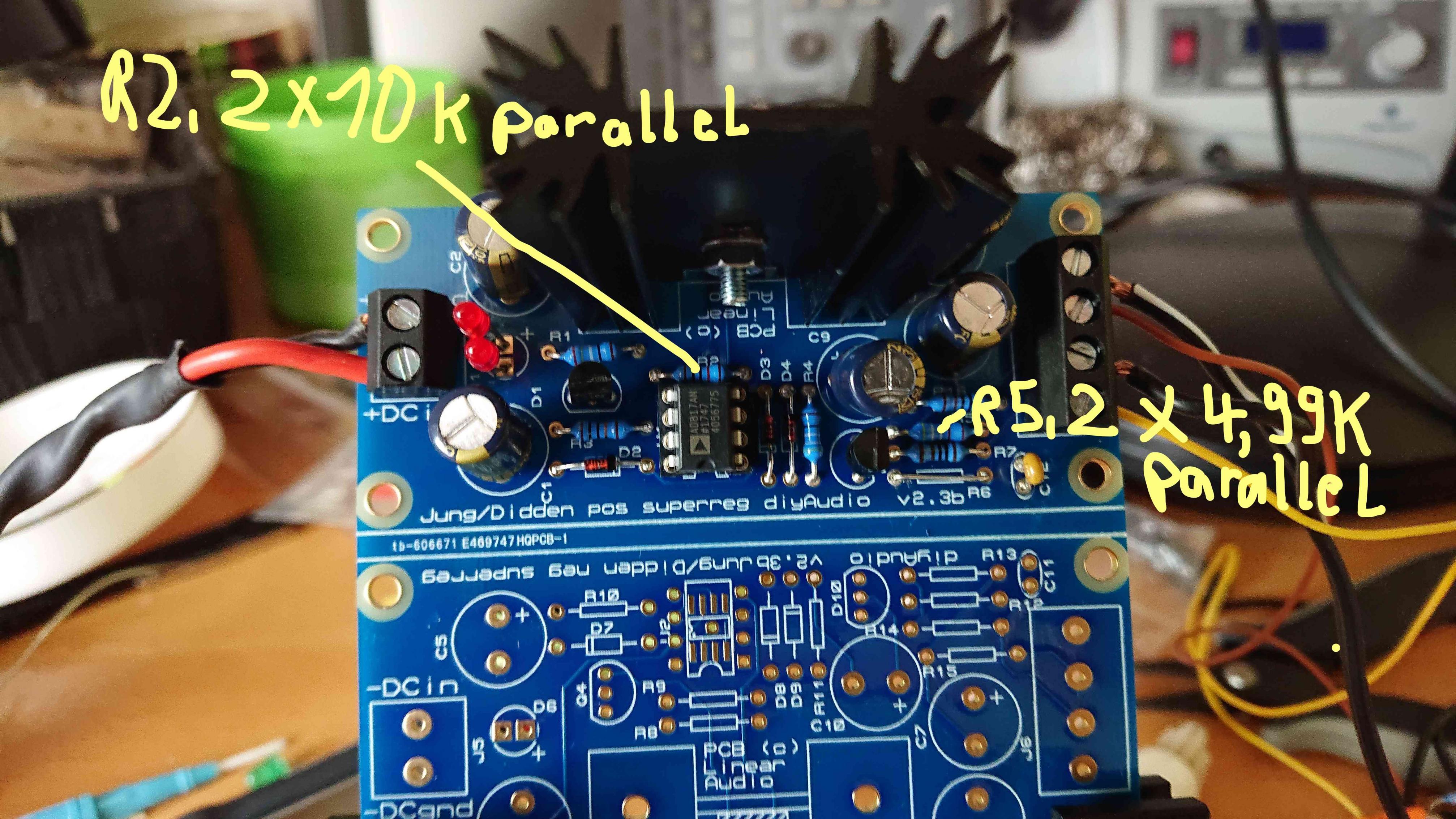

Hello,
I wanted to build a super regulator with 5 volts output, after post 535.
D2 LM4040AIZ - 5 / NOP
R5 2,5K
R2 5K
U1 AD817
D2 2 red LED serial
R6 bridge
R7 1K
Receive only 10 volts at 227R load resistor as output.
R7, R6 set the output voltage, they scale the ref. If R6 is bridged and the ref is 5V, you expect 5V.
You just have to remember that the inputs of the opamp need to be the same, the ref voltage value. Everything else is just ohms law ;-)
In this case both should be 5V. Are they? And what is the opamp output?
Also, on your pic I see 2 LEDs for D1, NOT for D2. What is the D2 value? If over 5V zener, it won't work. Just use a single LED for D2, cathode towards opamp output.
There's no reason to fiddle with D1.
Jan

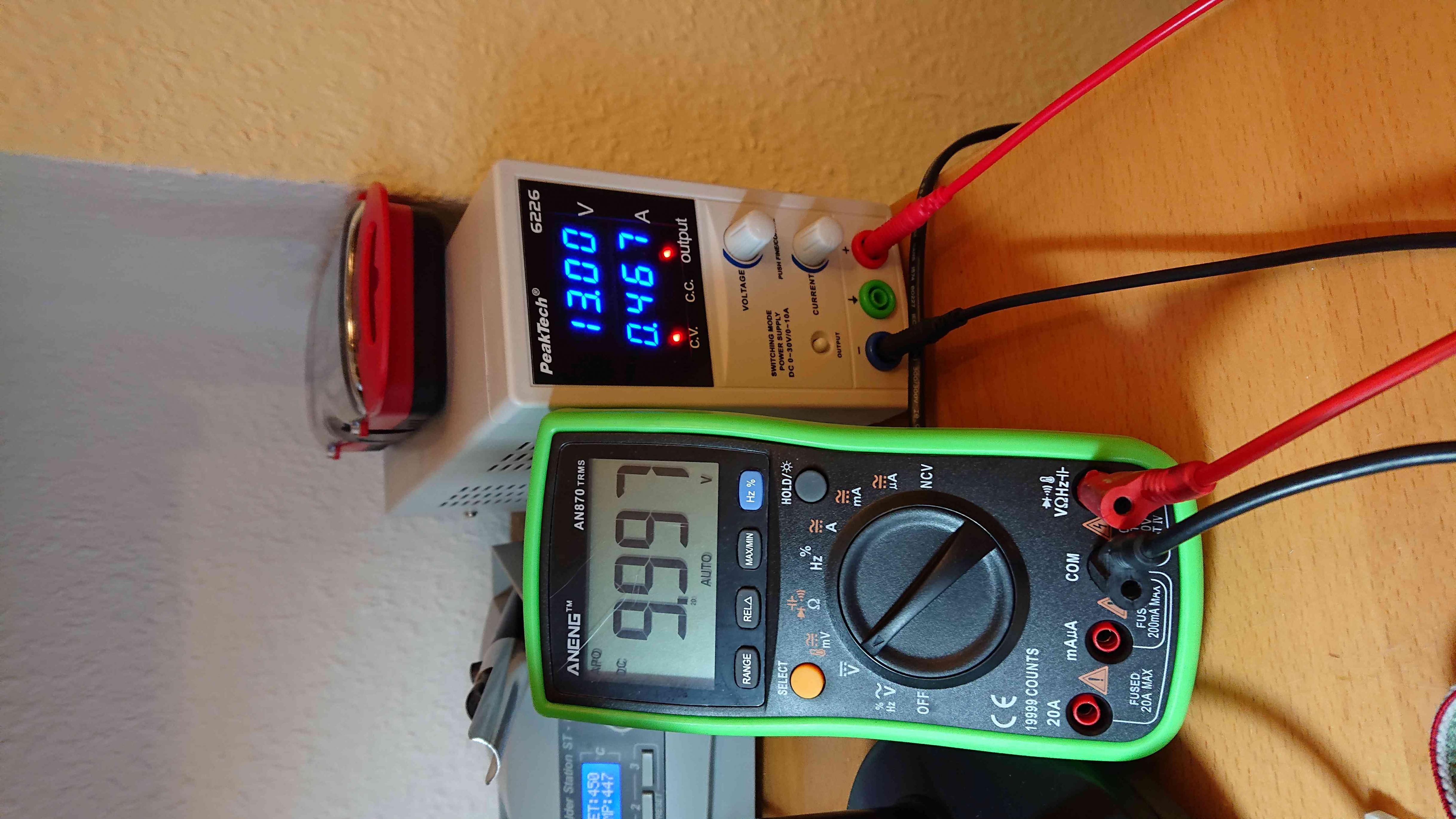

Thank you, Jan, for your help,
Zener diode currently 2.5 volts.
I mistook d1 and d2.
swap d1 red led again against green led.
Replace 10-volt diode with a red led.
Mass the Opamp values and then get in touch.
Yes. The series diode/LED on the opamp output is to make sure the opamp output sits not too close to ground or to its supply, because most opamps aren't R-R output.
Ideally it should sit at half the supply but it isn't critical at all.
Jan
Jan
should + 5volt
is. + 10.9 volts
d1 green led
d2 red LED kathode to ad 817.
ad 817
1 = 0.23V.
2 = 5.710V.
3 = 5.572V.
4 = 0 V.
5 = 0V
6 = 0,912V
7 = 11,762V
8 = 0,23V
Dirk
is. + 10.9 volts
d1 green led
ad 817
1 = 0.23V.
2 = 5.710V.
3 = 5.572V.
4 = 0 V.
5 = 0V
6 = 0,912V
7 = 11,762V
8 = 0,23V
Dirk
So this is good info. What do we see? The non-inv input is 5.5V, the reference. The inv input is 5.7, this is higher so we expect the opamp output to go down trying to bring the inv input to the same value as the non-inv input. And indeed that happens, output is as low as it can get with this opamp, less than a volt.
With the opamp output at 1V, and a LED in series with the output, the other side of the LED is expected to be roughly at 3V. That is connected to the base of the series transistor so we expect an output of say 2.4V. That is not the case.
That points to a LED the wrong way around. What is the voltage across the LED in series with the opamp output?
Jan
Jan
Red LED swapped and kathode controlled.
red led anode on pin 6 output opa 0v.
Kathode red led on pin 6 output opa 11.3 V
LED red anode on cathode measured 11.3V
Dirk
Dirk
Dirk
OK, so the LED was right way, with the opa output at 0V. Can you confirm that in that situation VLED anode = Vbase series transistor? What is the series transistor? Can you check it is correctly connected, collector to in input voltage?
What the opamp is doing is trying to pull the pass transistor base down, but not succeeding. Why?
Jan
anode led 2 opa output = 0V.
Q2 = BC556B.
Q2 Collector = Kathode Led2.
Q2= Emitter - Anode LED2 = 11,33V.
Q2= Bais - Anode LED2 =10,55V.
Q2= Collektor - Anode LED2 = 11,3V
Appendix Datasheet LED2.
D1= Grün 5V.
R2= 5K.
D2=Led Rot.
D5= LM4040AIZ 2,5V.
R7= 1K.
R6= Brücke.
R5= 2,5K.
Q3 = d4411
Dirk
Q2 = BC556B.
D1= Grün 5V.
R2= 5K.
D2=Led Rot.
D5= LM4040AIZ 2,5V.
R7= 1K.
R6= Brücke.
R5= 2,5K.
Q3 = d4411
Dirk
If you are saying that the voltage across LED 2 is zero you have a connection problem. Its anode is connected to the base of the pass device through R3, right? Or maybe you made R3 10k instead of 10 ohms?
So what is the voltage on the base of the pass device? Probably 12V or so?
Jan
Jan
I have found a mistake.
Led 2 not soldered against the diode blocking direction, changed.
Q2 = emitter - anode LED 2,2V.
Bais - Anode LED 1.9V.
Collector - anode Led 2,3V.
R3 10R
R2 changed to 10k original.
R5 changed to 4.99K original.
LED 1 + 2 now light up.
output 10,00V
Dirk
