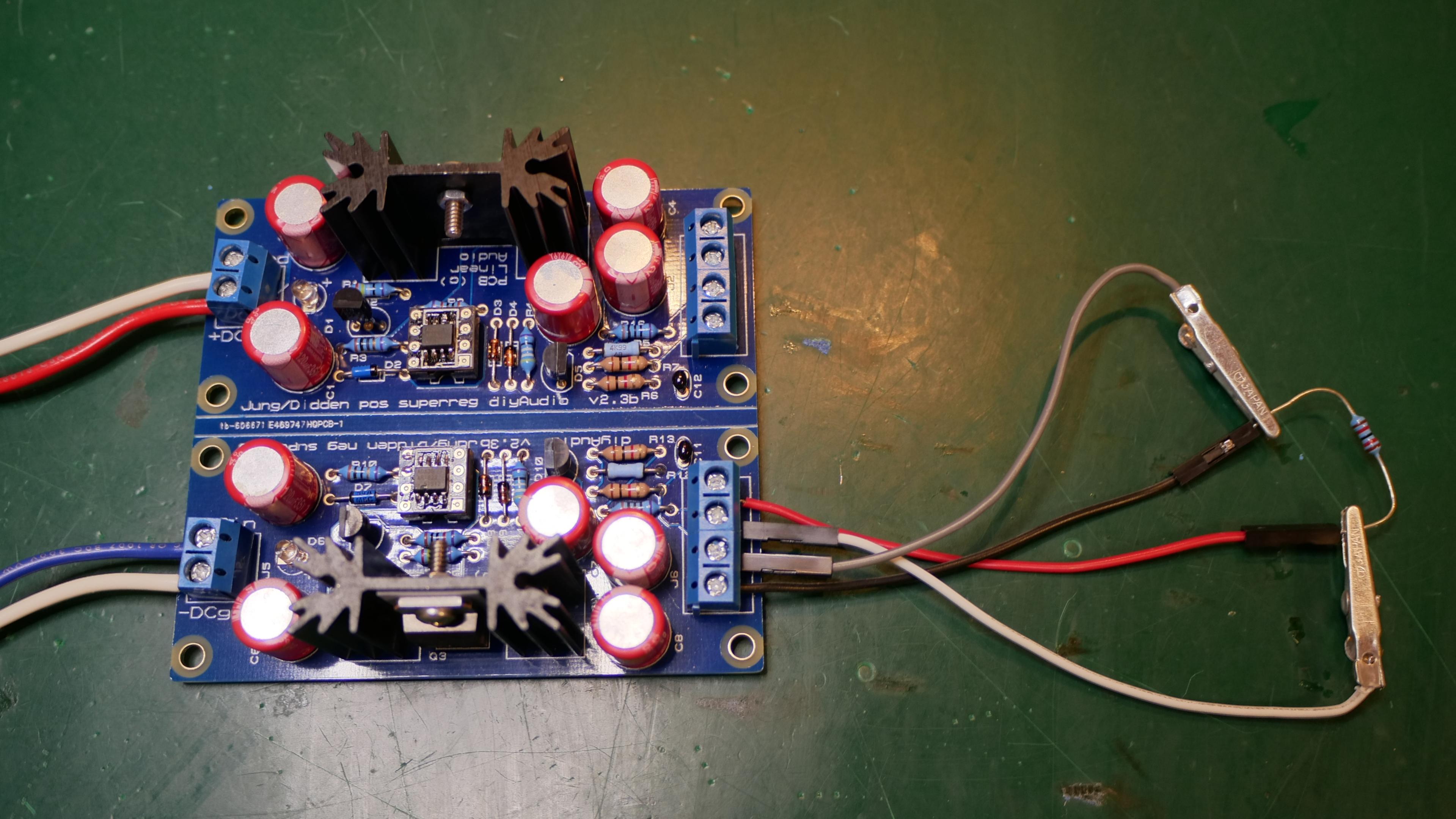

I recently completed the super regular board (v2.3b) using the standard BOM for +-15VDC output. I've been lurking here a bit reading posts. I'm running a 15VAC CT xformer into my rectification and filter board. I'm getting ~25VDC per rail going into the SR board.
On the output of the SR, I'm getting 25.2VDC on the positive rail and ~17.8VDC on the negative rail. 17.8 volts seems reasonable on the neg rail, but there doesn't seem to be anything being 'regulated' on the positive rail. No voltage on the sense lines on either rail. All measurements were made without a load.
I didn't skimp on the parts, as they were all new, sourced from Mouser here in the states. I've double-checked all the parts placement and values, and everything matches the schematic and PCB layout. I've re-flowed all solder joints as well.
I'm using the AD825 opamp, and have doubled-checked my soldering of the SMD on the 8-pin brown dog adapter. The pins all match. (Actually, this is my second set of AD825).
So, it would seem maybe a bad part, but not sure where to start looking. As with all my projects I buy extra parts, so I can do some replacing as necessary. Any ideas?
Havent looked at the standard BOM, but IMO if the Vref you are using is LM329, then the 17.8Vdc will be strange as well - with all the <1% tolerances in components, the output voltage should be some where near 15V, eg. 15.0x 14.9x... Perhaps the pass transistor on the pos rail is ESD damaged, try substituing it with a to92 transistor and hook up a 10k resistor as load😀
The give-away was that you have 25V or so at the output, and zero at the sense. Very likely it will be OK when you connect them.
If not, measure those opamp inputs and outputs.
Jan
That was it Jan. Once I connected the sense lines the voltages came down to 14.42 on both rails. Now to further raise the voltage to the desired 15v, I adjust the divider R6-R7 and R13-R14? Other thought?

I can't quite tell from the photograph; did you install "shoulder washers" between the bolt and the metal tab of the TO-220's in post #1650? If not then the tab is electrically connected to the bolt, which is electrically connected to the heatsink, through the hex nut on the back side.
No shoulder washer used. The heatsink is electrically isolated from the PCB so no issue under normal use. Now, if I go probing around.... It is just anchored on the PCB with large solder tabs. The shoulder washers I do have, do not fit those particular heatsinks.
Edit: Just so you know, this is not a practice I use, especially if the heat sink is NOT isolated from a PCB. But in this situation it works fine.
