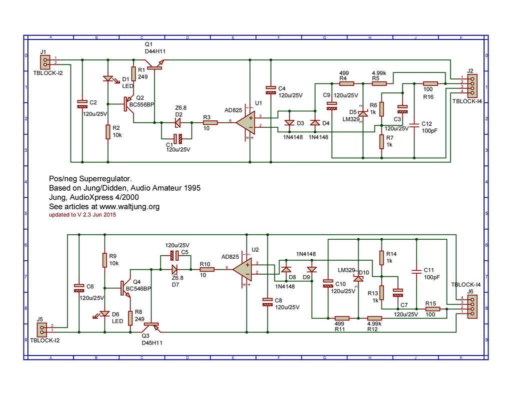

I have some problems with my superregs.

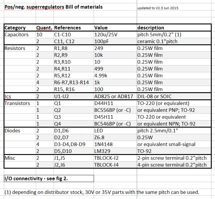

I used the pcb v2.3 of the diyAudio Store with the same BOM. I built 15v version.

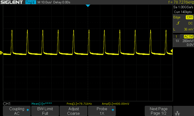

The output voltage is ok and handle input voltage variation (positive and negative reg) but I have noise/oscillation. Frequence and amplitude seem to increase with the load but not depend on the input voltage.
I used different voltage sources but there's no change. Positive and negative regs have the same problem. 😕

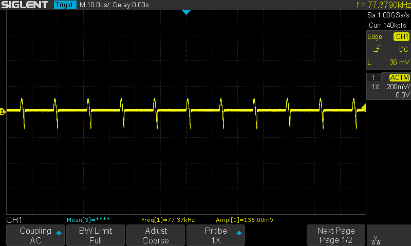

I joined a screen with 19v input and 100 mA load ( 150R ) (negative reg)
What should I check first ?

I used AD817 opamp. BC546C for negative and BC556B for positive. All others component are as the BOM.

I joined a screen capture*. The attached result was with 19v input and 100mA load (15v output)
I measure accross the load/resistor but I tried other point with same oscillations.
Oscillations are not visible in the source voltage alone with same load.

Ah yes, I should have known, you're French. Attached screen capture. I thought you 'joined' the wire screen to something. Sorry.

Yes that is weird, it points to some common stuff. Are you using a transformer with a center tap? If so, is the center tap connected to the two regulator ground points? Are output, ground and sense lines of each supply correctly connected?

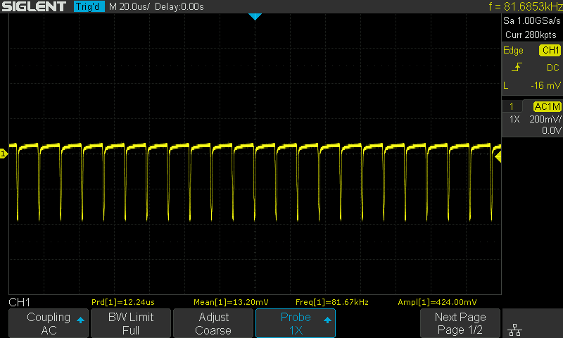

On the screen shot you showed, it seems like negative pulses. Is that on the neg supply? How does it look on the pos supply?

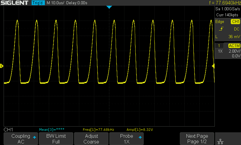

What do you see at the opamp output pin?

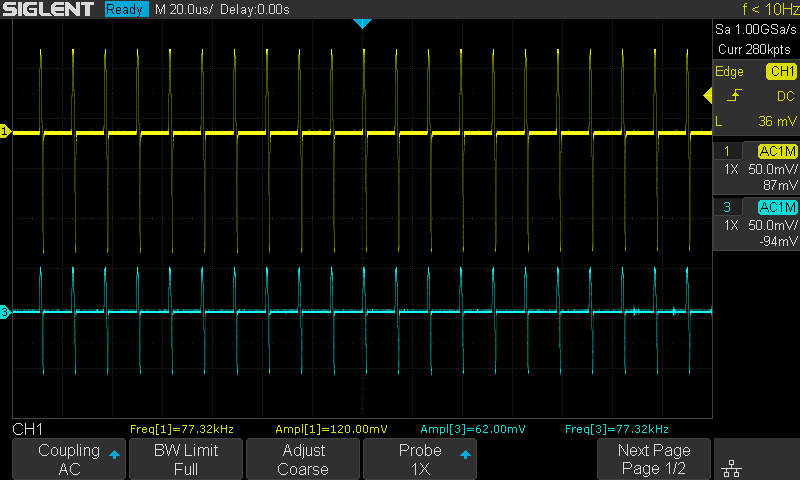

Yes it was the negative reg , I attached a picture of the positive reg (same as negative but inversed) and the opamp output (8v pikes ...). Pictures are from a test with 19v input (lab psu ) and 100ma load.
I saw something weird from the gnd in and gnd out (and then opamp -Vs) . I don't understand how it can be not flat.
I don't give up with this board I just want to see if the other have same issue to fix this one.

but it's not my scope ! I can see the pikes growing from GndIn -> R2/-Vs (blue) -> GndOut (yellow)

I found my mistake. I used 100nF instead of 100pF for C11 / C12. I removed it and there's no more oscillation. I tried some values to confirm and indeed big values make trouble...:headbash:
Sorry for that. Thanks for your help.
Good idea to read Walt Jung's original 1995 articles in which he describes the perils of "capacitor rolling" -- the impedance of the SR is spectacularly low and requires the ESR of an aluminum electrolytic on the output. Local decoupling with ceramics near the final destination are OK as the resistance of PCB traces or wires raises the impedance.
