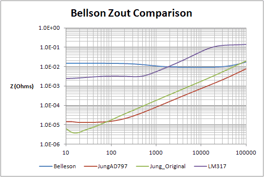

Rick, you may wish to review jackinnj's article on regulators to place the Belleson in perspective.
Jan
Thanks to you both for your advice.
I will use the capacitor!
I have read the article many times and know that the BELLESON did not rate as high as I would have thought it would in that test.
I will look again but I do not remember much being said about what was used before the regulators or if what was used was considered optimum. I might have assumed it was purposely slightly imperfect like the line stage circuit used was as part of the test.

I believe Belleson is now updated for lower noise, is the graph from the Linear Audio testing, it may nor reflect current production

See the first paragraph on p.175.
Tek PS5010 lab power supply and/or HP 6271 lab power supply, feeding Jung rail driver. Also see photo 1 on p.173.

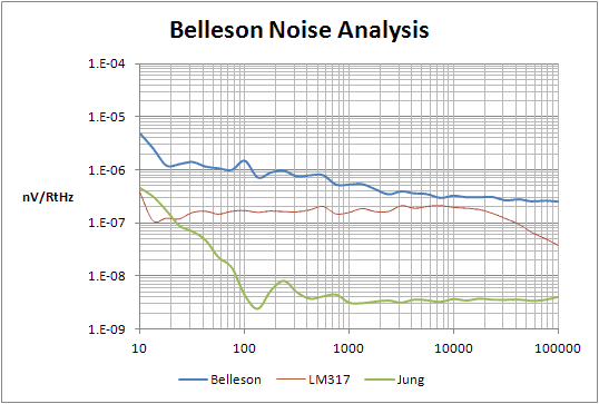

vertical axis on 2nd plot says nV/rt.Hz so the green line is 3E-9 nanovolts?

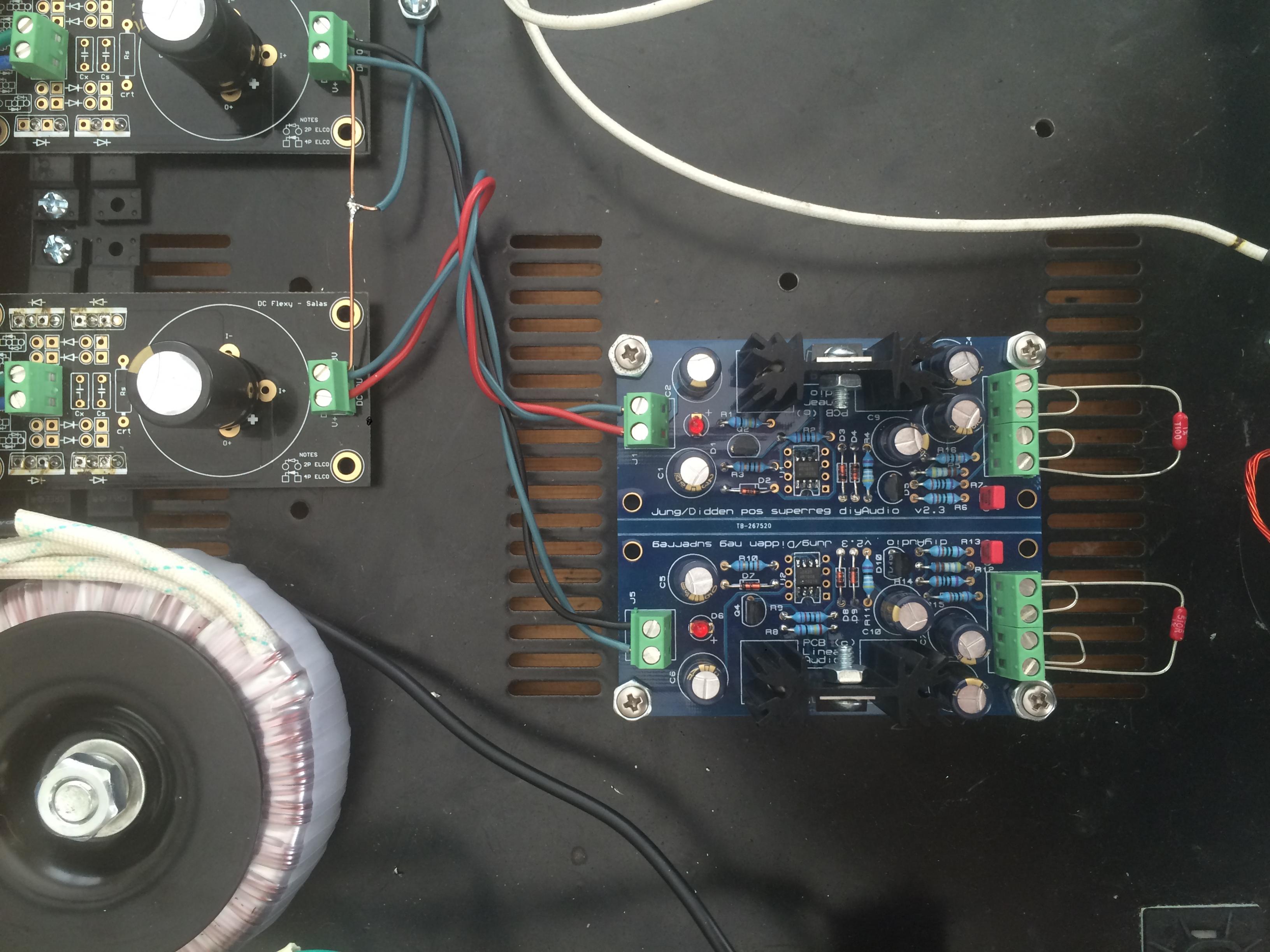

With all components standard except for R6 and R13, which are 750R, my led does not light up and the output of the regulator is only 1V lower than input. Input voltage is 15 and output voltage is 14V. I have roughly 12.2V across R6/R13 and 1.9V across r7/14. My intended output voltage is 12v +/-. D2/D7 have 1.68V across them, the lm329dz has roughly double that at 3.59V. Not really sure what's happening. It would appear that the opamp is not regulating but don't know why. Second set of boards with same results. AD825 is the op amp used.
The 329 is fed from the output so if the 329 only has 3.something across it, there's something wrong there. What is the series R for the 329?
Jan
Jan
I did not realize there was more than one.
The one I saw was not using mos-fets.
Go to Walt's site and click on "References and Regulators"
R5/12 = 4.99k per BOM
Have you checked the value? Checked that the connections are OK?
Is there 14V at the top of the R, is the bottom connected to the top of the 329, bottom of 329 to ground? Broken 329? This is called 'fault finding' ��
Your build looks OK. Have the pos and neg the same problem?
Jan
