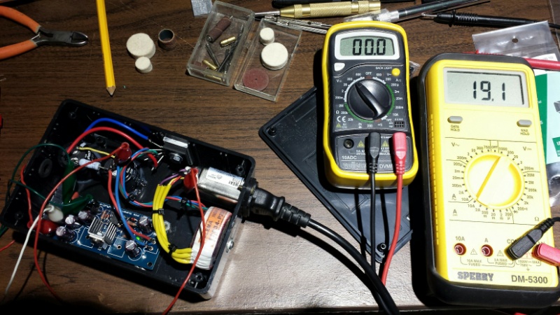

Mostly finished and tested. For some odd reason I'm getting 31 volts dc out of an 18 volt X 2 secondary toroid.
was aiming for 25.5olts, 384 mA.
Using it in parallel to double current and followed the toroid manufacturer's Pdf for wiring. ~32 volts after rectifiers too.
The reg is working fine at 19 volts. I calculated for 18 volts but it's ok for the B1. Caps are 35v.
Shunts and zener are 9.1v. R6/7 are 1k.
Amveco transformer but goes by other names as well.
Any idea why getting these readings? I have reversed the toroid's primary on hot and neutral. Could this cause the hight voltage?

Light loading on small toroids always gives you appreciable higher reading. Their 'regulation' is not very good; they are designed to deliver at least the rated voltage at rated current. What's the VA spec of that xformer?

Spec sheet says 7VA. That's tiny. Could it cause damage?
The load was 1k and 750 ohm resistors installed one at a time.

BTW- tried the AD8599ARZ opamp and it didn't work. Output was only 11v.
Unfortunately they are expensive, but fortunately when buying 4700uF caps, I picked up a few AD817 opamps. Dropped right in and get 19v.

No damage but such a small xformer runs pretty high if not loaded down to spec. Nothing to worry about as long as your caps can stand the voltage.

A 7VA 18Vac 25% regulation transformer fed with rated primary voltage will output 18*1.25 = 22.5Vac. Convert that to DC using sqrt(2) and you get 31.8Vdc
Subtract a little for two diode drops passing near zero current and you have ~30.8Vdc across the smoothing capacitor.
Increase the Mains voltage a bit and you have well over 31V. subtract a lot for the sagged voltage when delivering substantial current.
18Vac 7VA has a Maximum continuous current of 194mAdc
1k with 31Vdc across it is only 31mA
add on 750r for 41mAdc.
Combine them for 72mA. But by them the voltage will be down a bit so <70mA delivered.
