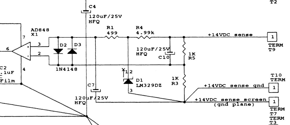

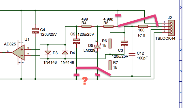

In the Version2.2, the C9, D5 and R5 are connected differently, compared with from the previous version.
Any benefits of such modification?

Seems to be a mistake? I assume that the schematic is identical to the pcb layout.
On the PCB, C9 is connected to ground, not ground sense. R5 is connected to Vout, not Vsense. So the PCB is identical to the schematic.
If you suggest that C9 should be connected to ground sense and R5 connected to Vsense, that is a different story.
