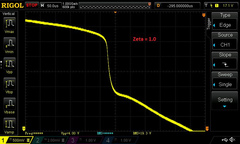

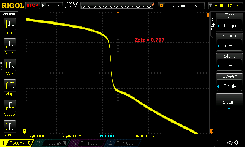

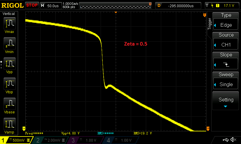

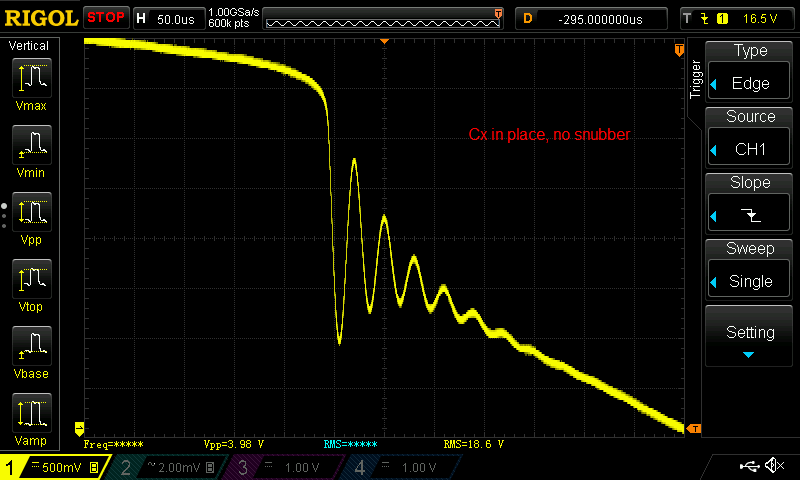

Yes. Fortunately this is easy to eradicate. All you need to do is measure the secondary leakage inductance*, plug it into Hagerman's formula, and install a snubber
  • Rsnub = (1 / (2 * Zeta)) * sqrt(Lleak / Ctot)
Voila, diode-induced transformer ringing is perfectly annihilated, to whatever damping factor Zeta you prefer. Hagerman suggests Zeta=0.5; myself, I prefer Zeta=1. Either way the transformer secondary ringing is stopped completely; dead. The cost is modest: (2 capacitors + 1 resistor) per secondary.
Attached are some measurements made by diyAudio member DNi and posted to a thread in the Power Supplies forum of DIYA. They show an unsnubbed secondary winding, and then three different snubbers with three different damping factors (Zeta). The scope is triggered at the instant when the rectifier diode cuts off.

Yikes, one of those images was a miniature "thumbnail" instead of fullsize. Sorry about that! Here's hoping all four come out correct THIS time:

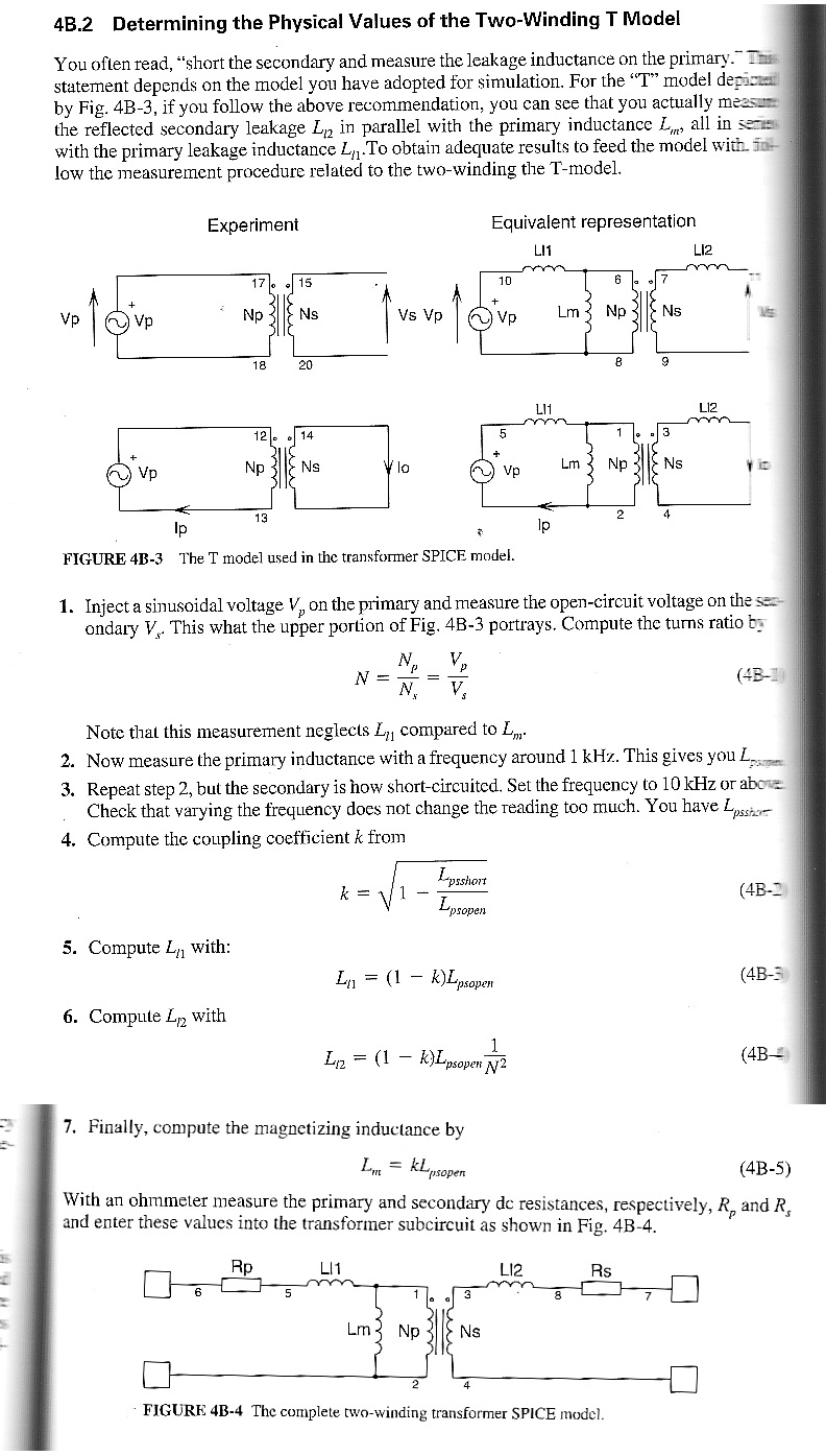

In the formula you refer to LLeak is measured from each secondary with primary shorted: correct?
D
I recommend you read Hagerman's snubber paper and also the Quasimodo snubber-design paper.
The most thorough exposition I've ever seen, is in Christophe Basso's textbook, excerpt below. However Basso is concerned with high frequency switching power supplies and the transformers used in HFSMPS. Plain ordinary 50Hz/60Hz mains transformers, probably do not require the same level of precision; they operate on a very leisurely timescale (milliseconds!) so there are no uncomfortable trade-offs between power and noise-reduction.
Basso is careful to isolate and extract ONLY the secondary leakage inductance; however it may be preferable to use the effective secondary leakage inductance in snubber designs, with the primary's leakage inductance reflected (thru the square of the turns ratio) into the secondary. A few SPICE simulations may help you decide which one you prefer.
The first way to skin the cat is (i) measure Lleak and Ctot; (ii) select a desired Zeta; (iii) calculate Rsnub using mathematics.
The second way to skin the cat is (a) connect the actual transformer, rectifier, and snubber together in a working circuit; (b) electrically stimulate the circuit and observe the oscillatory ringing on a scope; (c) adjust Rsnub potentiometer until ringing disappears. This is the "no-math" approach.
