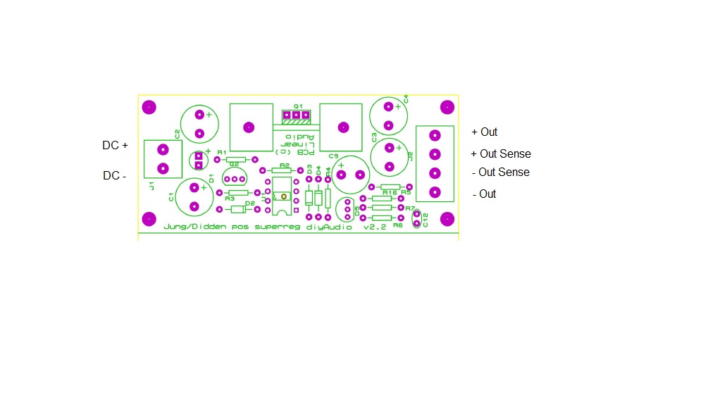

Need a little help here. Almost done! 🙂
Can some one clarify the in and out of the v2.2 board?
Looking at the board from left to right, J1 top pad looks like it's negative and bottom pad looks positive. But as I read the article, it sounds like the opposite. Please see attached and tell me if this is correct or not.
Thanks,
Vince

You're absolutely right Vince, the top of J1 is the negative terminal and the bottom is the pos terminal.
I will fix this.
BTW Where did you gt that drawing I don't think I made it?
Jan
It appears that the link for the user guide you get from the DIY store did not point to the latest version.
I took the latest versions and corrected it as per Vince's findings, see attached.
The BoM is correct for the V2.2 with the remote sense filters. Also removed the connectivity list from the BoM as this is now shown in fig 2.
I will see how I can get the link in the DIY store to be updated to point to his version. That file will also be higher resolution.
Sorry for the confusion,
jan
