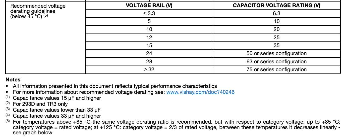

Vishay TL3 and KEMET T489 ,unfortunately Mouser does not have all the values but for output voltage up to 20V there is no problem with the choice.
Thank you for these. I see why the TL3 is an attractive cap for this board. I looked at the DS of these and apparently they need to be derated by as much as 50% even under 85 degrees C!? If this is true, then what is the point of rating them like they do? Here is a snip:
Footnote 5 appears to indicate that they can be operated at up to the rated voltage under 85 degrees, but the table seems to suggest that a 30V rail requires a 63V rated cap or placing more than one in series. Both aren't really doable (63V doesn't even exist in the TL3 range which only goes up to 50V and series placement would bring down the capacitance too far). Strange. I'm taking this seriously as there are plenty of posts on this and other forums warning for 'spectacular' failures of solid tantalums when operated without proper derating.
What about the T83? They are the same form factor, but more usable values are available (i.e., up to 63V, suitable for decoupling a 30V rail considering the above). They don't have the extremely low leakage of the TL3 but don't look too bad. And even as T83s are only available at Mouser and Digikey in the 'low' ESR variety (product designation ending on "L" instead of "S" for standard ESR), the ESR is probably not problematic.
Leaded tants could be an alternative, especially for the T83s: relatively low DCL and inductance spec but probably higher than SMDs.

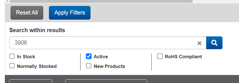

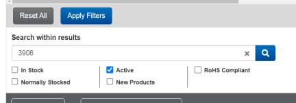

For my home-made "PM329" 6.9V shunt voltage ref I want to build a small board preferably with SMD components. Have you figured out some SMD components to use for this like you did for the GLED431 in Jung's shunt regulator? If so, I'd be much obliged if you shared some suggestions for the 2N3906 PNP and PN2222A NPN transistor.
The Zener is available in SOT-23. The PN2222A is TO-92 only, but the 2N2222A is available in a hard to hand solder UA or UB package. I assume this is a drop-in replacement but is there anything more solder-iron friendly that can be used instead or is good ole TO-18 the best choice?
When I visit the parts search website www.octopart.com , and when I type "2222A" into its search box, octopart returns some surface mount transistors in the SOT-323 package and others in the SOT-23 package. MouserUSA has > 200K of them in stock and on the shelf, ready to dispatch.
Similarly, when I visit mouser.com and surf to their Discrete Semiconductors -> Transistors -> Bipolar Transistors chart, and then type "3906" into the "Search within results" box, I get lots of different options in surface mount packages. MouserUSA has > 1.6 million of them in stock and on the shelf, ready to dispatch.
A quick comparison of the surface mount transistor's datasheet, versus the thru hole transistor's datasheet, confirms or refutes the hypothesis that they are interchangeable (except for power dissipation!).
