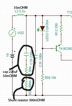

Hi, please see picture, shunt is at the cond not at the input. The same L(C+R) is at the out. Can I post here complete simulation?

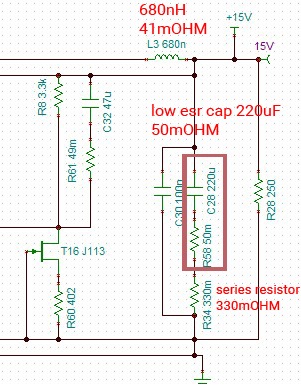

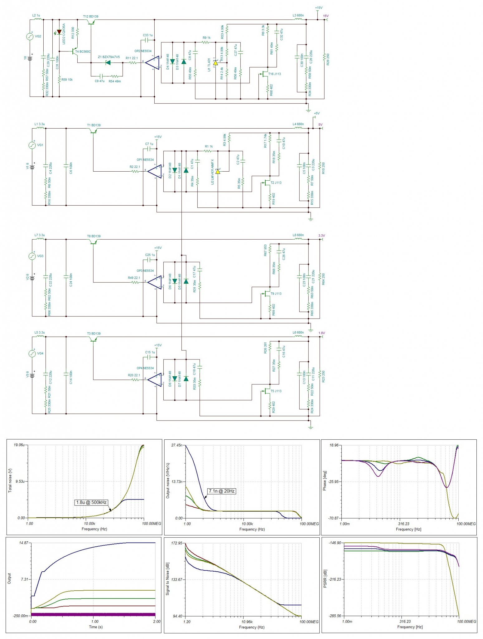

I have done things diferently, instead of resistor divider I added fet, and fb is connected at the star between coil and cap, it improved things a lot, would be happy if somebody confirm improvement. Also as Didden told there should be no low esr cap at the out, instead I have added some series resistance, see picture. I'm using NE5534

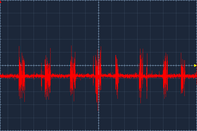

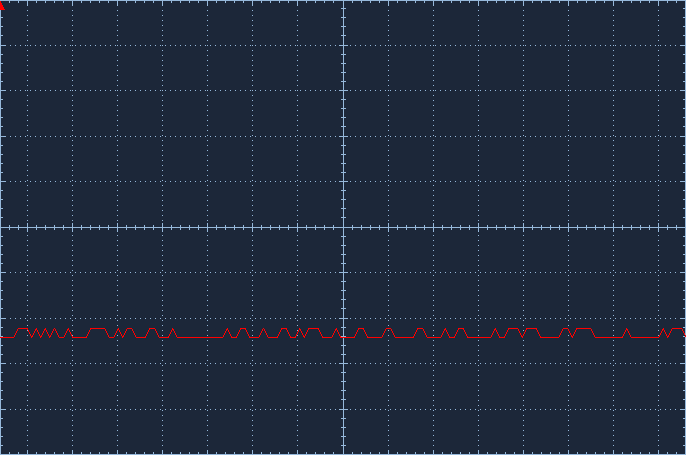

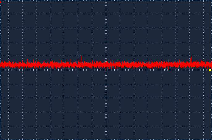

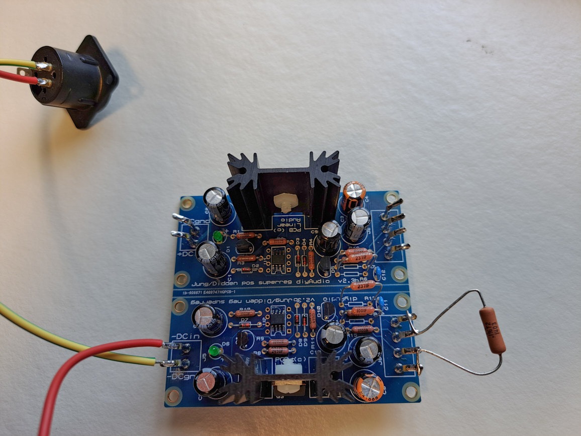

Well, I've finished building my first superreg:
voltage divider resistors still mounted provisionally. Voltage is within a hair of the theoretical value given the Vref and resistor values at 23,98 V and -23,97 V (loaded with a 1k resistor as shown). Opamp is the OPA1611.
When I put the probe of my scope on the output of the reg ( + or - leg of the 1k resistor, ground clamp of the probe to the return leg of the resistor) I'm seeing some strange pulses. Similar on the pos and the neg regulator. They also show up when I measure a 7809, so it might just be some interference the scope picks up? I'm not really an expert here.
(2mV/div and 10mS/div)
