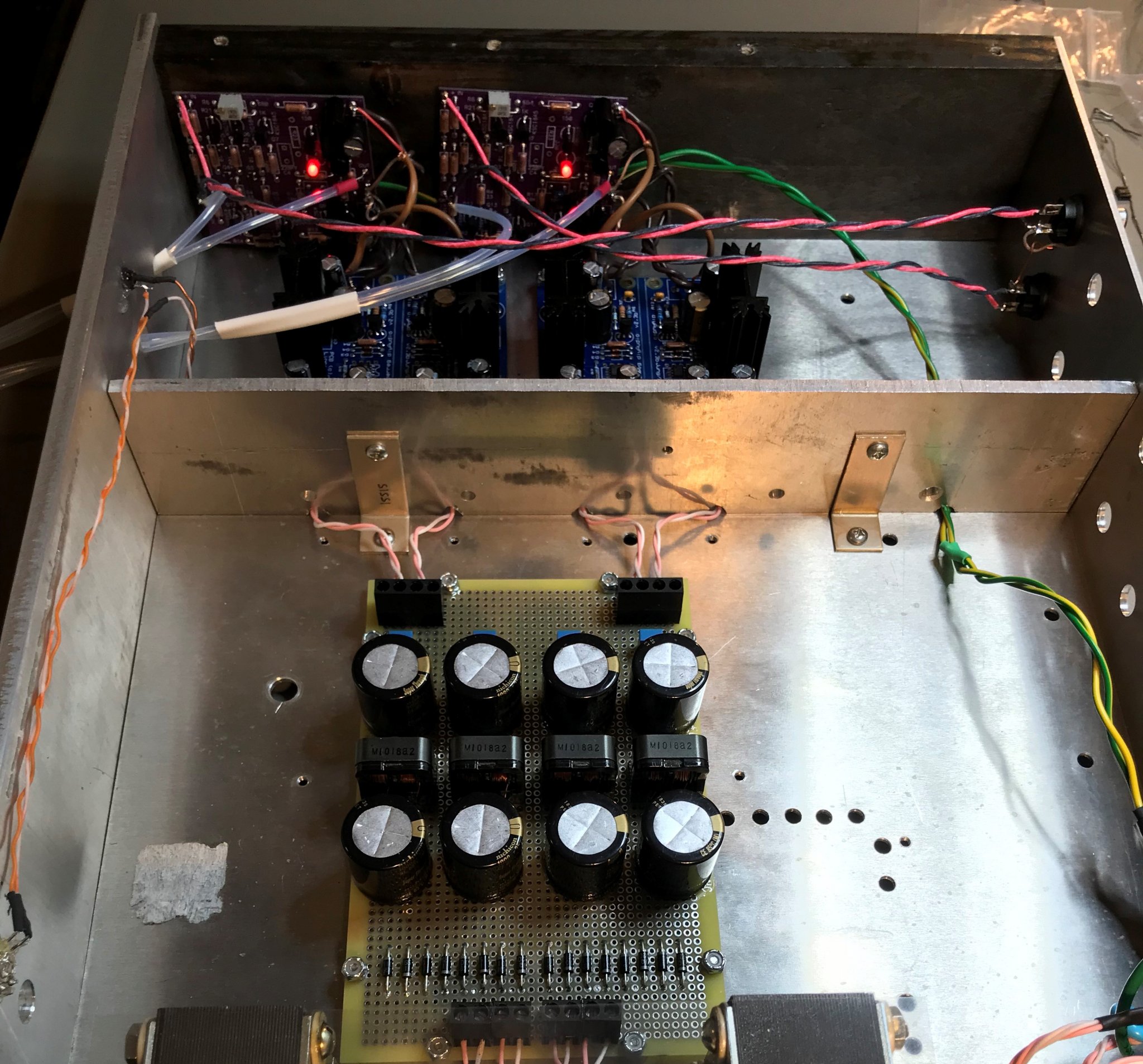

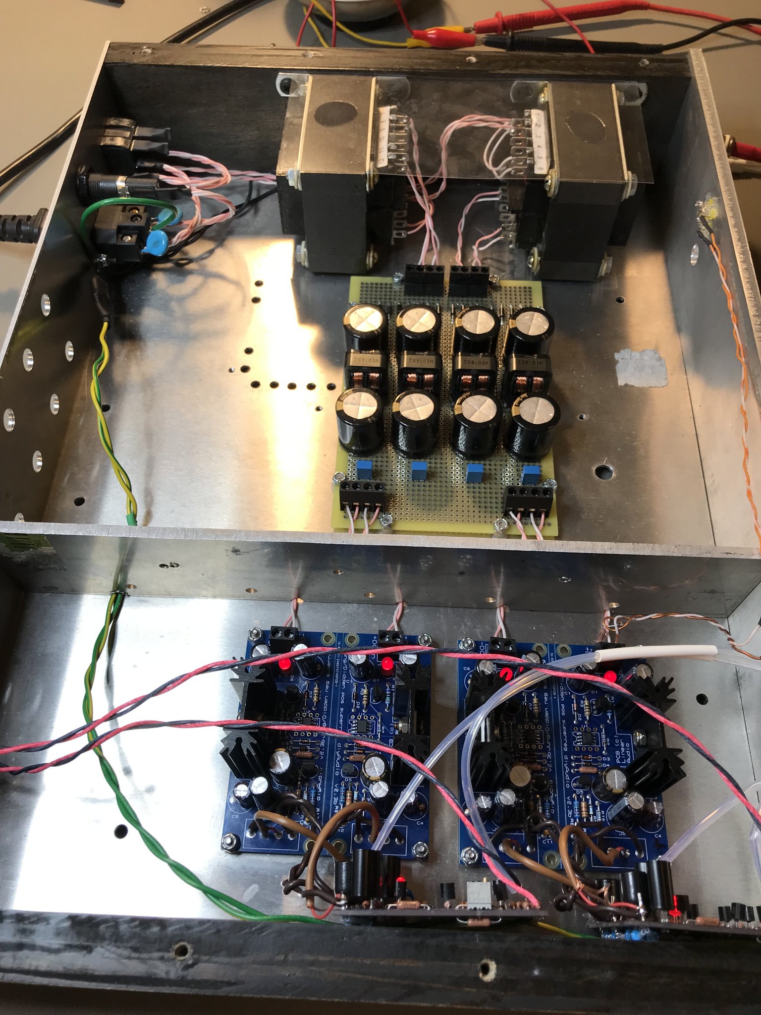

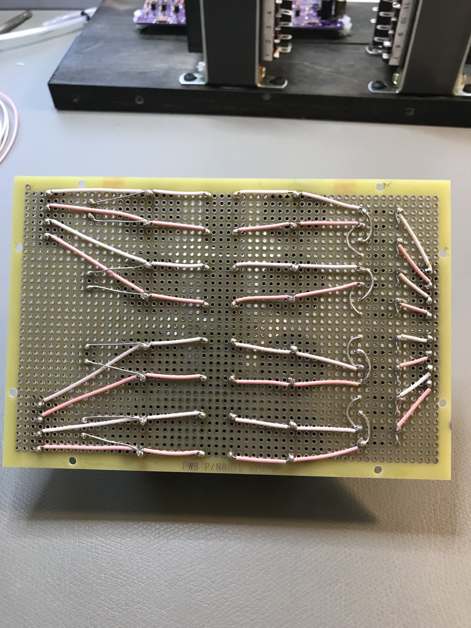

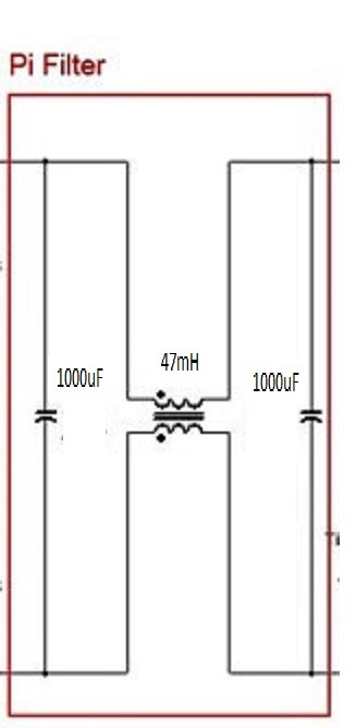

A properly implemented superreg is no joke. This is the best SQ I've achieved yet in my room. Stumbled out of the gate with my first attempt due to my own lack of attention, and awarded with oscillation. This is my 4X gain discrete opamp (BA 2018) with the alternate beefy output transistor option, able to drive headphones, autoformer, etc. Dual bobbin xformers, raw DC supply with 47mH CMC's between some type 3 Nichicon UKZ's in a Pi filter arrangement. Reg's have WJ's improved voltage ref update, AD825 op amps.

How did you arrange your grounding? You seem to be isolating supply and return for each transformer secondary through separate regulators to the preamp board. Are the signal grounds isolated from the shield? Is there a "star"?
More importantly for this thread... where did you attach the sense wires to the preamp circuit? Did you try various points?

Hi William and congrats on your build, super impressive! I use a +5V SR as a USB power for my DAC, Aqua La Scala (balanced PCM1704K, frame-grid Telefunken ECC801S) and the sound quality is stunning compared to anything else I've tried.
I am also planning to build a +/-18V SR for my phono preamp, Rega Aria, as well as for other parts of my stereo. So I wonder if you'd be willing to help by sharing some of your experiences and details of your build. I use a 13V 16AH LiFePO4 battery at the moment, but your choke rectifier looks great. I wonder if you could please post the schematics and the list of parts you use, including the upgraded parts in the SR.
Are you saying that the discrete opamp did not work and was oscillating, but AD825 work fine? I also use AD825 (powered by 5V twice lower the specs), but I want to try other options. Also, what are the boards at the very bottom of the photo?

Yes that's right. Isolated all the way through finally meeting at the client (load). The wiring gets very "busy" at the load where it all comes together. Connection diagrams are shown in the old Audio Amateur "Regs for High Performance Audio" articles. On the sense wire I used Mogami 2552 (I think, or 2549? can't remember). With the shield connected only on the regulator side. Sense wires connected at exactly the same point as the load wires on the client. Didn't try anywhere else.

Hi Alex. I'm not a phono guy and have no experience in that realm. But I suspect the PS needs to be really good, and quite possibly you would want the raw DC portion in a separate enclosure connected with an umbilical.
Walt talks about the SR tweak here: https://refsnregs.waltjung.org/An_Improved_Reference_Filter_for_Audio_Regulators.pdf
I liked Gary Galo's approach in his old articles with the dual bobbin transformers and CMC's with a line level project. Regarding attenuation of high frequency junk riding on the mains. Caps: LKG1V102MESZCK, B32529C1474J289 CMC: SSR21NV-M10475 Transformers: A41-80-36. Bridge rectifier diodes are 11DQ10's.
My discrete opamp had .1uF film cap decouplers on the rails, SR did not like that one bit! My own fault for thinking I could get away with it... laziness mainly
Purple boards are the gain stage, given out at Burning Amp 2018 by Wayne Colburn.
