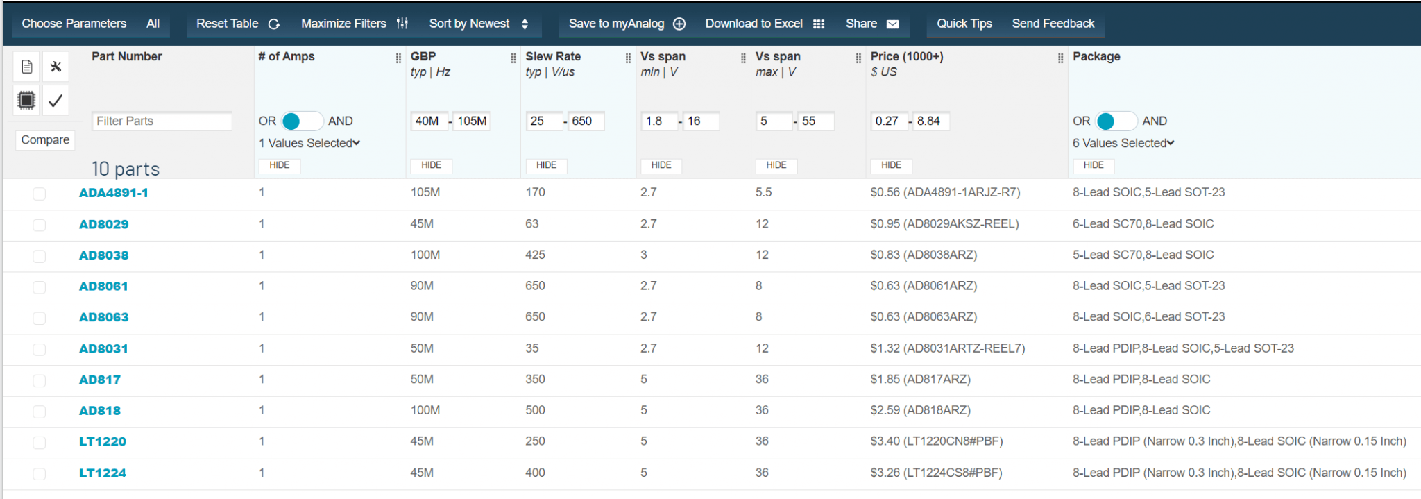

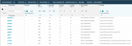

There is the issue of opamp bandwidth, that is correct, but there are surely opamps with similar bandwidth and slewrate as the AD825 but working on 5V (or even 3.3V).
I've had good results with the AD8031.
