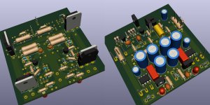

Below is my 70x70 mm pcb project, with non-inductive resistors in feedback loops for both superreg and JLH, and bigger very high-temperature electrolytics, and additional bypass foil capacitor for zener diode in superreg (lower part). The last thing that bothers me are the vertical resistors crossing the legs of upper power transistors (180R shunts).
Also: i added a shunt 4,7k resistor at the gates of power transistors of superreg (where input CCS meets the output of AD797), non-inductive carbon-comps - would that help somehow to speed up the regulator?

i drew additional long thin trace from the point of regulation, i.e. input leg of JLH power transistor. On this trace i planned place for either a wire link or some 0R22-0R47 resistor.
At the end of this trace i placed the V+ of AD797 and lm329, and stabilizing output capacitor (https://www.vishay.com/docs/28465/190rtl.pdf).
I chose those Vishays mainly beacuse of their high temperature resistance (6000h at 125C),
At the bottom of ad797 i put additional 15uF mlcc, soldered directly across op amp`s legs.
both 100uF/50V from Vishay, and 15uF mlcc have very low ESR and impedance, and are effectively parallel.
Considering the output stability with these very low impedance caps, i decided to controll it with a resistor, and not to rely on the ESR of the capacitors.
what would be the best routing of the V+ trace? (> means trace, // a pour for parallel elements)
pointVreg>>0,47R>100uF elco>0,22R>15uF mlcc // AD797 // lm329 ?

If you have this already, why not try it. It's not ideal, but few things are in life ;-)

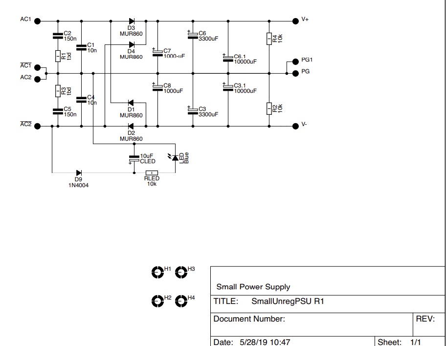

True, but if ideal is within reach, I can skip straight to ideal. Would this mean separate bridge rectifier for each secondary winding and NOT what's shown in #2511?

What you need is two separate rectified/reservoir cap raw DC voltages that do not share a common ground. This can be two separate secondaries with bridges, or two separate secondaries with mid taps and pairs of diodes. Just your 'normal' setup but then two times.
