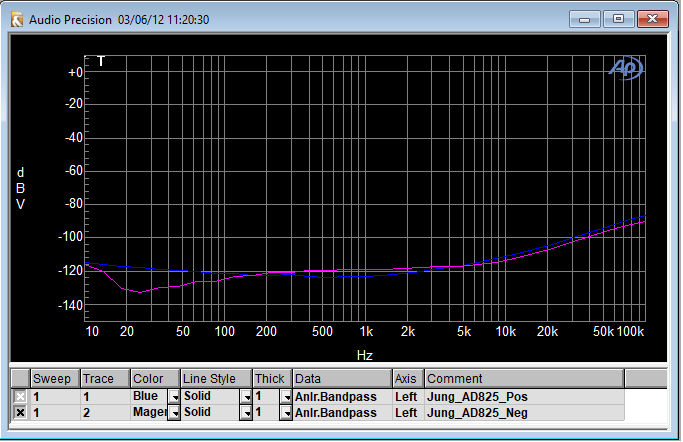

If you're worried about noise etc in the kHz to MHz range, by all means do NOT use the LM317 circuit in the new Texas Instruments data sheet. It's output impedance is measured in Ohms.
Super-Reg has prodigious PSRR (see chart below) and will cost less than an R-Core transformer. Mark's two-transformer idea will eliminate the nasties from DC on the mains!

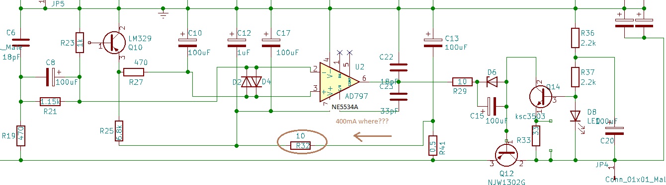

i have a persistent problem with negative voltage rail, it keeps giving me on 7.4 Volts instead of 17V
once i decoupled the oppamp psu with additional RC 10R 100uF tantalu + 1uF ceramic across, i see unexpected high dissipation on my R32 on schematic (10R), with too high 470mA current and little bit of smoke.
Funnily, without the voltage, the resistance of both legs of this transistors are some kR and rising. Where is this low impedance coming from ??
Could it be just soldering error ? Or if i is it the NE5534A that is soldered in NOW instead of AD797 ? the compensation capacitors at legs 8?
I have already resoldsered and measured both decoupling caps, and reversed the zener, no help. NE5534 a second one soldered with ESD care.
the positive rail with the same arrangement works fine.
Any ideas ?

Exactely the same situation with lm336-5 in , same voltages round. this lm329 works fine outside the board.
I measured against ground around 8 legs, all seems i.O. (Brymen 896s with sharp needles). Decoupling 18pF and 33pF seem fine. (DER EE)
can it be the NE5534A Onsemi model itsefl ? Second one works just as the fist one, 7,4 Vout, high dissipation on 10R, smoke. caps shouldn do anything if unused..., positive rail works fine though!
pin 7 and 8 as usual connected, just covered with painted in actual model, shouldn`t have put it there, my mistake.

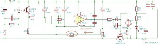

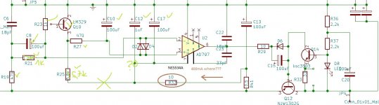

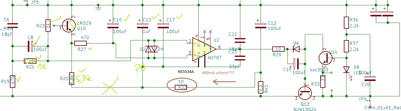

yes, some year ago. I wanted to do it as good as possible, short straight SMDs, straight power connection on single 80x80 pcb. Everything went fine, JLH1969 measures well, positive rail has some ca 270kHz 5mV noise,
negative rail like stupid shows always 7,4V out, due to some "dark magic" involved here ;-)
