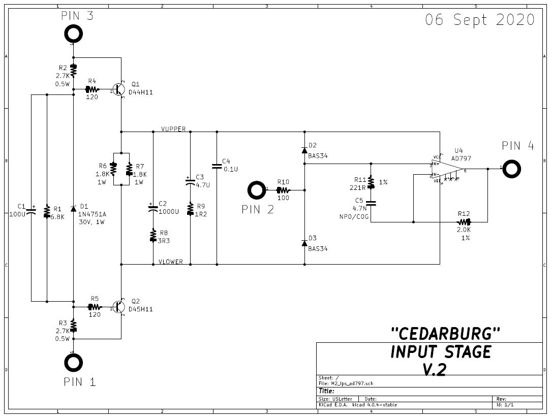

AP uses 47pF between pin 6 and pin 8 of the '797.
The little Cedarburg card I designed for the M2x power amp, has an AD797 without external compensation capacitor. Pins 1, 5, and 8 are floating. And yet it's perfectly stable at unity gain.
Mark, thank you so much for your insight. I am not an expert and I wonder if you could please explain how your post translates to using AD797 specifically in the Super Regulator. Should I leave certain pins floating or try without a capacitor, etc.? Thanks again! -Alex
_
Scott would know best but I think the cap from 6 to 8 is the distortion cancellation cap (decomp when to GND), and it's actually harder to make the circuit unity gain stable with it populated.
