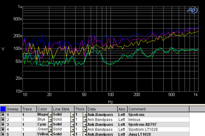

Mr jackinnj has once again done some noise measurements and my pcb behaves quite nicely although the difference is small.
The Invisus regulator is a 185 dollar product.
Noise is only one parameter. It would have been fun to know the output impedance as a function of the frequency.

Nice results! Considering that at 1kHz the difference in noise between the best and the worst seems 200nV, the real practical difference MIGHT be in the output impedance. As noon as you wiggle the load there'll be a lot more than microvolts ripple at the output. It would be nice to see, at least Zout at a few frequencies, 100, 500, 1k, 3k, 10k, 15k?

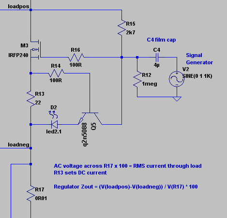

For what it's worth, I've attached the mosfet load setup that I've tried. The mosfet makes a current limiter, with R13 setting the DC current. The AC current component can be inserted with a signal generator.
I just don't know if this is correct for measuring the output impedance.

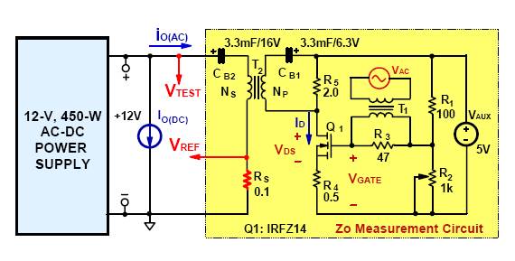

Have a look at the figure attached. The transformer doesn't need to handle any DC.
This is out of the paper I mentioned before,
http://www.deltartp.com/dpel/dpelconferencepapers/33.3_10275.pdf
I simmed the circuit -- you've got a pole with the leakage inductance of the transformer T2 to contend with -- I measure mine at 800uH -- so the use-able frequency is limited. I think a more traditional current driver. To make it easier, I have a bipolar supply to drive the MOSFETs. I'll try it....
For the original article I used the generator of the AP S1 feeding a capacitor (electrolytic) coupled current into the reg output. You can use the genetaor output Z (like 150 or 600 ohms) as the voltage to current converter. Then measure the resuting voltage at the reg output, of course. The max AP generator Vout is about 15V RMS, and with 150 ohms that allows up to 100mA ac current. Should be enough.
There is an AP app note for measuring amplifier output Z but the concept is the same (I think it is app note 1 even).
