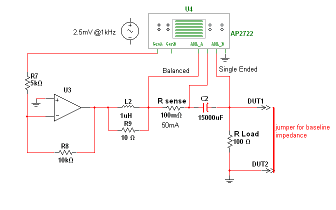

This is the "Baseline Impedance", i.e. the impedance of a jumper across the impedance measuring nodes from 10Hz to 200kHz at the point where it would make contact with the SR. The jumper is flat copper tape, a foot of which (30.5 cm) has DC resistance on the order of a milliOhm, obviously there's less distance involved here. There's only a tiny bit of the insulation of the two conductors between them (I stripped it out) so if there's any leakage, it's the conductivity of "air". It would appear from the article that WJ's impedance at 20 Hertz is 4.3 milliOhms. Mine is on the order of 32microOhms.
I also ran the test with a 100 milliOhm non-inductive current measuring shunt and it looks exactly like series "C" in the article.
The setup (sorry Ikoflexer) -- as Jan had suggested I used the 20R output impedance of the AP generator, calculate the difference between the generator's output, and the output at its BNC jack to calculate the current (1V - V(GenMon)). This has a 50 ohm cable going to a 10,000uF/50V capacitor to inject the perturbation signal into the DUT. I download the voltage measurement into Excel and change it to current.
The DUT is connected to an amp very similar to the SSM2017 shown in the 2/95 article -- only difference is that an SSM2019 is used as the '2017 is obsolete. this amplifies the output across the node so that the impedance of the cables connecting to the AP is nullified. I can verify that the noise of the SSM2019 amplifier (powered by batteries) is less than 2nV/SQRT Hz. at 10Hz. (The input impedance of the AP isn't ideal -- it's 100KOhms/100pF or therabouts and add to this the impedance of the cables.) I can select gain of 10,100 or 1000 with the amp, and check to make sure that the measurements are consistent.
Thank you for the explanation; if I understand correctly, in the attached image, U3 is the SSM2019 preamp, and the shunt copper tape is connected between DUT1 and DUT2?
This part is not clear, sorry. The generator output is not exactly at the BNC jack? Or do you mean the reported/set generator output, which is meant to be some value, but at the BNC jack something else is measured?
What do you measure the rms voltage with? I'm finding myself not trusting very much the values I measure with my instruments, as they don't agree with one another even on one decimal place.
I was using that setup -- the amplifier OPA544 or whatever doesn't have such hot bandwidth and isn't that quiet, so I just took up Jan's suggestion. Something like an LME49600 has plenty of bandwidth and is very low noise but as of yet I am too lazy to install it. You have to remember to bring the DC on the electrolytic low by shorting the leads, the AP isn't happy with DC on the generator output.
The SSM2019 has a pair of 49.9 ohm current limiting resistors, some back-to-back eletrolytics (220uF Elna Silk) for bypass and diodes to clamp DC at its inputs. It amplifies the voltage across the 100 ohm resistor

To Iko - the AP has a built-in Zout. Say you use the 50 ohms setting, and set the generator output (which is what the AP sends into the Zout) as Vgen. Then you measure the output voltage (which is what comes out of Zout, into the BNC which sends it to the DUT), call it Vdut. Then you calculate the current into the DUT as (Vgen-Vdut)/50 ohms
