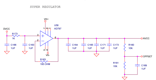

Hey guys - I have some "super regulator" questions, but it's not this same circuit. Just and op-amp looped around.

See the attached below. It's from the Sabre ESS data sheets for 3.3V use on the analog section of their DAC chip. Pretty simple. 3.3V in, 3.3 out.
I use basically the same in my DAC (ESS 9006) sans the offset and with different caps. Seems to work fine, very quiet. I have not used the AD797 but have tried some others. (some are not stable)
But what I don't understand is what the heck is it regulating? The only reference is the voltage at C136. Certainly the opamp can supply enough current, but it should be "dirt in, dirt out" - right?
Anyhow, it does work and seems very quiet. But I'm at a loss as to what it's really doing, other than supplying some current.
The answer is simple: nothing. Garbage in - garbage out. And it's actually a little less quiet than the reference voltage DVCC, slightly filtered at the input.
OTOH, it allows you to filter the DC input, and then buffer that filter with the opamp. That's what it does. I would prefer to use a quiet reference as input, like a precision 2.5V ref with the opamp having some gain, but it's the designers choice I guess.

Yeah JD, that's what I was thinkin'.
Clean up the DVCC and then buffer it. The filtered DVCC is the reference.
Agreed that a better ref and a little gain makes more sense. That's probably how I'll go in the future - if I don't just switch to an LT1963.
The AD797 may get very upset with that capacitive loading. And those 1.2V or 2.5V references are not at all quiet. And adding gain will certainly add output noise as well.

Actually you can filter DVCC more heavy than shown, and then use for instance an LME49600 as buffer. If syn08 agrees to that 😉
